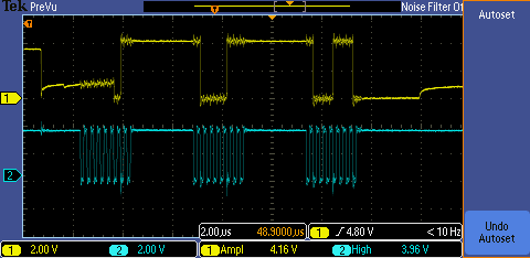

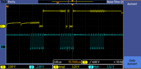

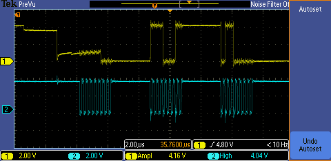

    I have 5V reference voltage. here are some images from oscilloscope.
    1) input voltage at ADC =0.451V , i am reading equivalent value via SPI =2827 (0xB0B) but from oscilloscope image i am getting value code =5688(0x1638). With 5V reference i should get 5688(0x1638) value which is equivalent to 0.45V.
    2)input voltage at ADC =1.14V , i am reading equivalent value =7199 (0x1C1F) but from oscilloscope image i am getting value code =14552(0x38D8).
    3) at input voltage at ADC =2.4511V  and 4.517V i am getting similar way.
    it seems I am getting proper reply from ADC but when it comes to SPI readings i am getting half of the oscilloscope code value.
    Am i loosing LSB bit in SPI reading? If you want i can update schematic.
