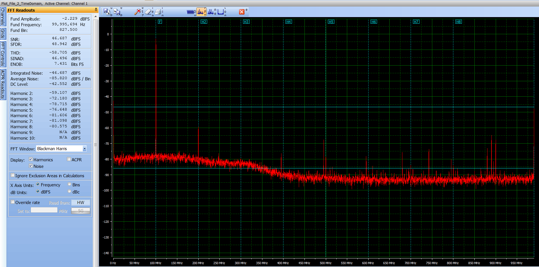

  • As a quick example. Here are the results for a 100MHz input signal sampled at 2.8GHz (demux and DES mode). Only one channel (I) and the four channels (I, Q, Id, Qd).
  • Hi Sergio
    The spurs that you are seeing on the EVM look larger than normal. Please make sure your ADC is calibrated after to warms up. Please also make sure the signal source you are feeding into the ADC is clean please use bandpass filter to clean the signal before it is fed into the ADC.
    I don’t have ADC10D1500 board with me so I am making these measurements on ADC10D1000 in DES mode.
    Here is the filtered signal but the ADC has not been calibrated after power up and ENOB is about 8.0 bits.
    Here is the unfiltered signal applied and you can see ENOB is 7.4. The ADC has been calibrated
    Here is the measurement done after part has been calibrated and input signal is filtered with a band-pass filter. As you can see I am getting the ENOB of 8.4.
