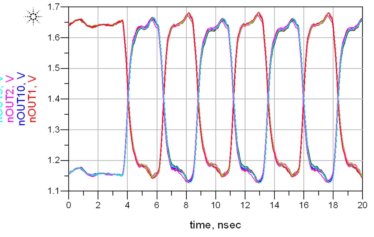

I’ve developed a clock distribution network to feed 60 ADS5527. I’ve used LVDS signal. At the clock distribution network output I’ve obtained the waveform shown in the attached figure. Is this clock waveform acceptable for ADS5527?

    The minimum Input clock amplitude differential (V(CLKP) - V(CLKM)) is 0.4V. After looking at your clock waveform, it looks like this value is ~ 0.32V. To meet the data sheet specification, you will need to increase this amplitude. The part may work with this level of clock amplitude, but it will not be guaranteed.

    Following your suggestion I've updated the clock distribution network in order to increase the amplitude of the input clock (LVDS). The attached figure shows the new waveform observed at the input of the ADS5527. Is this clock waveform acceptable for ADS5527?

    If the frequency is 210Msps or below and at least 0.4V p-p, and the duty cycle between 35% to 65%, it should work. I cannot tell the duty cycle of your waveform, but the amplitude and frequency appear correct.
