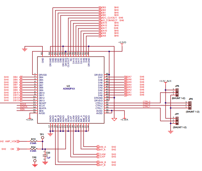

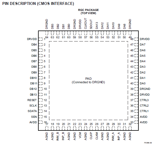

Is the inputs polarity (INP_A/INM_A, INP_B/INM_B) in the datasheet right ?
<datasheet>
19pin : INM_B
20pin : INP_B
29pin : INM_A
30pin : INP_A
<EVM>
19pin : INP_B
20pin : INM_B
29pin : INP_A
30pin : INM_A
<My comments>
I tested it on the following conditions in EVM.
  • Parallel mode
  • SCLK = 0 = (0dB Gain)
  • SEN = 5/8*AVDD = (Straignt binaary and parallel CMOS output)
  • CTRL1 = CTRL2 = CTRL3 = Low = (Normal operation)
  • 19pin = VCM
  • 20pin = Swept DC Voltage (from 0.5V to 2.5V)
  • 29pin = VCM
  • 30pin = Swept DC Voltage (from 0.5V to 2.5V)
The results are as follows.
0.5V : 0x3FFF
I think the Pin placements in the EVM schematic are right and those in the datasheet are wrong.
Please check it and answer it.
