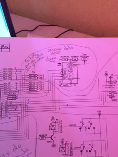

  • Hi Hocine,
    Apologies, the resolution of the picture makes it impossible for me to read the schematic. Also, it will be necessary for me to get a capture of both digital transactions occurring in order to give you a good review of interface. This is because there could be problems happening when the output toggles.
