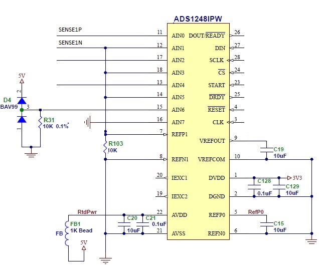

I'm trying to do a resistance measurement between AIN0 and AIN1 of the ADS1248, but the numbers aren't adding up...
I use IDAC Current Output 1 to drive 1ma to AIN0
   IDAC 0 Reg 0xA = 6; // 1ma
   IDAC 1 Reg 0xB = ( 0 << 4) ;  // AIN0
but I read 0x7FFFFF for all but very small resistor values..   I do see 1V across R103 (10K), suggesting that the 1ma constant current source is working.
How can I calculate the resistance across AIN0 & AIN1 ?

    Are you sure that you are using 1mA for the excitation current? 1mA x 10kΩ is 10V. It would make more sense if you are using a 100uA excitation current.
    First, about the schematic. I would remove FB1 and replace it with a short. The inductance in the supply line could cause you some errors. With the digital line (and even with the analog line) there are switching currents, that will cause voltage spikes with the L(di/dt).
    For your measurement, make sure that all of your excitation current flows through the resistor you are measuring (across SENSE1P and SENSE1N) and the reference resistor (R103). Then, make sure that you are using REF1 as the reference input and that you have the internal reference on. The internal reference needs to be on to use the excitation current source. Then make sure that there isn't anything else in series with the inputs that might be adding to the measurement signal. For example, an input filter is often added to the front end of the input at AIN0 and AIN1. If the excitation current is driven from AIN0, then the filter resistance on AIN0 becomes part of the measurement error.
    Once you verify that the proper current is going through the measured resistor and the reference resistor, then it is easy to verify the resistor value. Since the ADC output code is a measurement of the ratio between the input voltage and the reference voltage you get this relationship:
    Measured resistor = (reference resistor x output code)/2^23
    Remember that if you want a stable measurement, you need a stable resistor. Typically the reference resistor is high accuracy and low drift.

  • Ok, removed FB1 with a short, I also verified there is nothing else connected to AIN0 & AIN1 except for a 1k resister (measured).
    The reference resistor is currently 2K (measured). I've experimented with different values, but the schematic hasn't kept up...

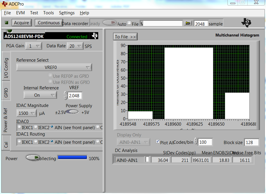

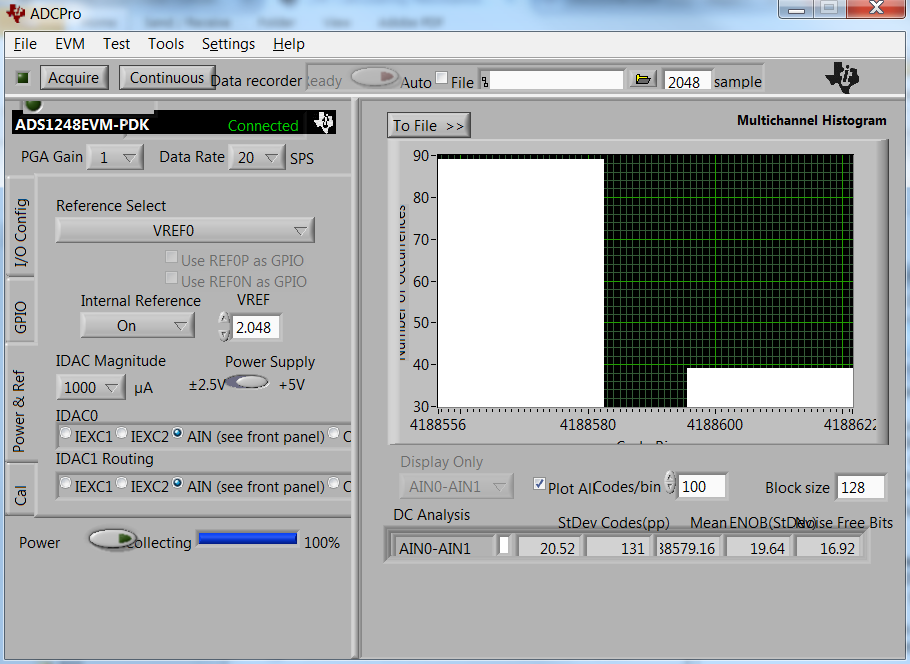

    As an experiment, I set up the ADS1248EVM to test this out. I have 1k resistor from AIN0 to AIN1, with IDAC0 set to AIN0. Instead of REF1, I put 2k across REF0, and connect the negative end to AVSS, and the positive end to AIN2 so that the current is shunted through the reference resistor. I used REF0 instead of REF1 so I don't have to de-solder resistors to disconnect the REF5020 on my board. IDAC1 is set to AIN2, which is an unused channel. The internal reference is set on so that the IDACs are operational.
    Because there are some series filter resistances on the inputs, I short out the filter resistor on AIN0. If I hadn't done this, the IDAC current would react to the series resistance to give some added error.
    With a 1mA excitation current, 1.001V is seen across the 1k resistor, and 2.005V is seen across the 2k resistor.
    With a 1.5mA excitation current, 1.406V is seen across the 1k resistor, and 2.816V is seen across the 2k resistor. Note that this is a bit lower than the full 1.5mA of excitation current because the current source starts to lose compliance to the postitive rail. Even though current starts to droop, it generally shouldn't affect the measurement because the same current goes through both the 1k and 2k resistors.
    With the 1mA excitation current, the measurement comes out to 4188579, with the 1.5mA excitation current, the measurement comes out to 4189631. In the first measurement, that comes to 998.6Ω, for the second, that comes to 998.9Ω. Even though it should be the same, there are a few differences in the circuit that may account for the difference in codes. First, if you make the same measurement remember to remove the multimeter first. This adds to the error since this gives an added leakage for the excitation current. Second, since the inputs are different there may be a different input current (imagine that the input has a equivalent input impedance, and I wasn't able to short the other series impedance on AIN1). Also, the inputs have different common-mode points, which may also have a different common mode error.
    Regardless, it's certainly possible to get a result that makes sense. I'm sure that there's a simple explanation why your reference resistor is showing a high voltage.
