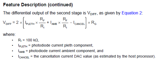

I would like to ask you a question about "ambient noise calcel" as below.
There is a following equation on datasheet p26.
Here, we can control "I cancel" value is from 0 - 10uA, step 1uA.
For example, in case of Rg=100K and Icancel =1uA, output value of "cancel" part is 0.2V.
 (2*Icancel*Rg = 2*1uA*100K = 0.2V)
On the other hand, the full-scale of the ADC is +/-1.2V.
I suppose the cancel voltage of 0.2V seems to be too rough against ADC range. (0.2V vs 2.4V)
I am afraid this is not very useful for SpO2 product.
Will you tell me how to improve the resolution of "I cancel" if you know?
Or if my understanding is not correct, please let me know.
