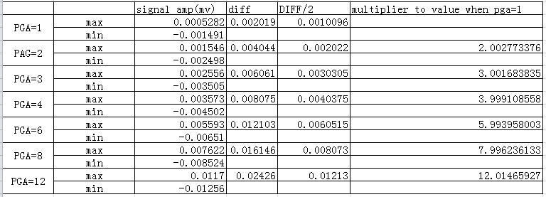

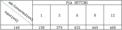

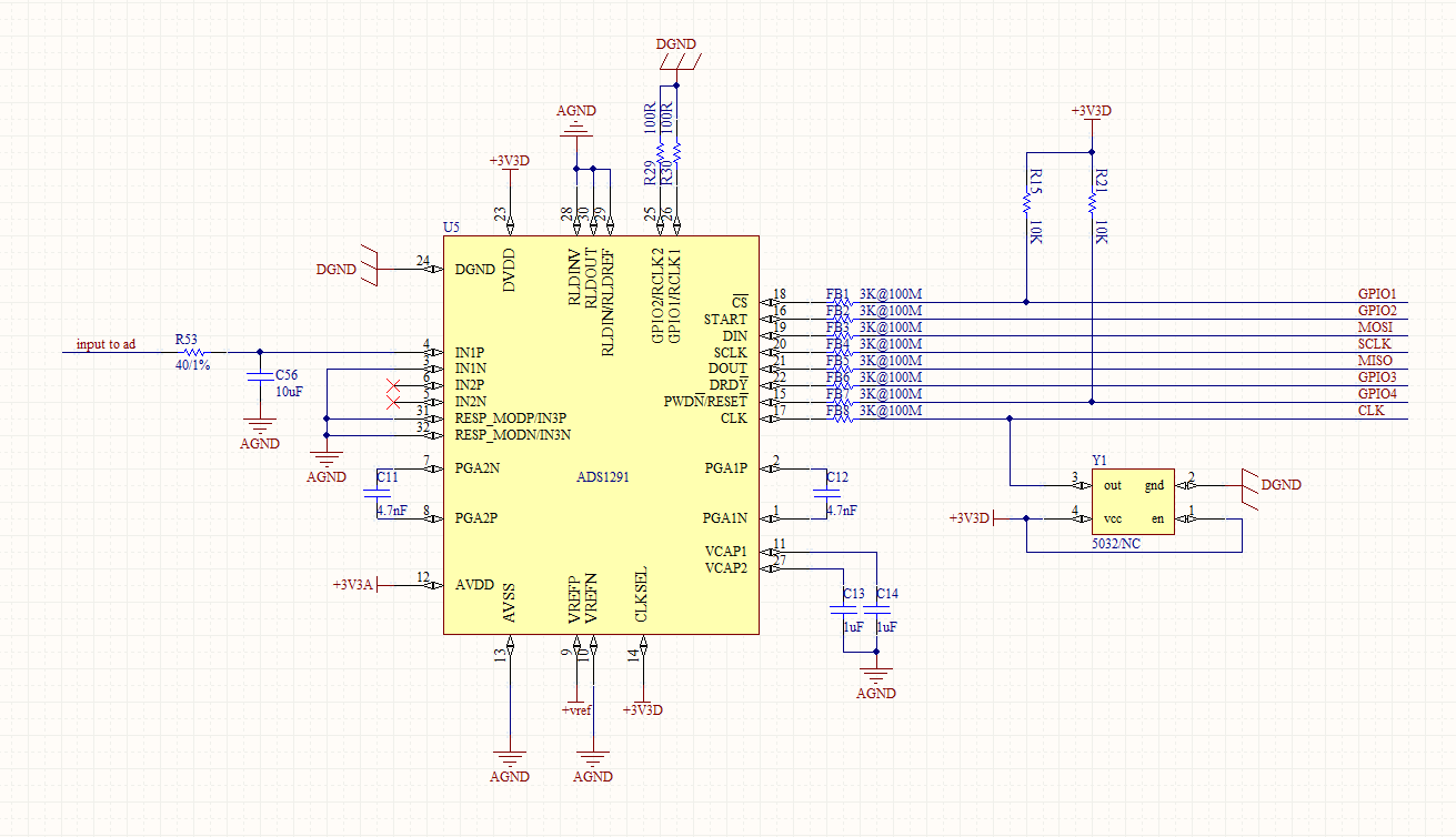

I am making a gadget with ads1291, I happened to found the pga setting is not that i used to think of.
As many function described in the datasheet use the pga setting directly. such as Vref/pga.  From this point, it seems to be linear. however this is what i found:
Here the pga setting does not look like either linear or db. what's the problem?
