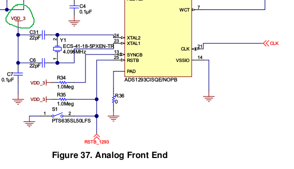

I am trying to communicate between ADS1293 and CC2541. I got my PCBs made based on the Wireless Heart Rate Monitor reference design (link: http://www.ti.com/tool/TIDA-00096). I also got the firmware from here.
I did not observe any notification data when ECG notification was enabled (using BTool).
When I observed the SPI signals with an oscilloscope, during a write/read from ADS1293 registers I observe the following:
1. sclk consists of two bursts of 8 clock cycles each, as opposed to a continuous burst of 16 cycles, which is the requirement as per ADS1293 user guide (ADS1293 EVM also shows 16 clock cycles). Is this a problem?
2. MISO line is always low (it is high in ADS1293 EVM when idle), which means that there is no data coming from ADS1293.
3. MOSI is fine - data is written MSB first, on the raising edge.
When I compared my PCB schematics with TI Reference schematics, I see that the resistor on the SDO pin is missing in my schematics. Is this a problem?
Thank you for your help.

    I found another difference between my PCB schematics and TI reference schematics. It must be an oversight.
    My Schematic
    TI Reference
    My crystal oscillator is not connected to Vdd. Does this mean that it is not running?
    If that is the case, would SPI be affected - because SPI runs on the clock derived from SPI Master, it must be independent of the crystal oscillator.
    Thank you
  • Hi Sudheer,
    If you have the SPI signals at the pin of the part (not probed somewhere along the trace to the part, but actually probed at the pin) the signals should be read by the ADS1293, if everything else is connected correctly.
    Yes, you need the connection of Vdd to XTAL2 and XTAL1. If the internal oscillator is not running that would make it so the SPI data does not get into the Digital Control section. The ADS1293 also will not run internally, because it does not have its clock to make it run.

  • Hello Mike,
    I did not set SHDN_OSC to 1 in the first case.
    I did the check suggested by you.
    On the evaluation board, voltage on IN4 changes from 1.9mV to 3.2V when I change RLD from IN4 to IN6.
    However this does not happen in my board - neither 1.9mV or 3.2V. The pin seems to be floating (default setting of RLD).
    No, nothing is pulling SDO down.
    I have also tried with a new board (I got five of them made) and obtained the same result. Hence it is not part problem.
    My PCB design is same as wireless heart rate monitor reference design (TIDA-00096).
    The only major flaw in the circuit is that crystal oscillator is not connected to VDD.
    I guess, I can now assume that this is the reason why SPI is not working?
    Can I go ahead and get new PCBs made with this corrected?
    Thank you
  • Hello Sudheer,
    You say:
    This would seem to indicate that the SPI signals are not being read by the ADS1293.
    You can try reworking your current board so that the crystal is connected correctly, before you make new boards. You should probably also carefully check the rest of your board for any other differences before making more boards.
