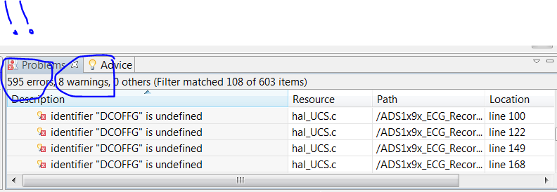

Could you please provide us a compilable/Buildable demo software for the ADS1292RECG-FE dimonstration kit ?
Other Parts Discussed in Thread: ADS1292R, ADS1292RECG-FE, ADS1292
Dear E2E TI team,
Our future design based on the ADS1292R TI solution, it for eheart monitoring application.
We have just make the order for the  ADS1292RECG-FE demonstration kit to start Software test and development in parallel with hardware design.
I downloaded the open source software provided by TI in this link ADS1292ECG-FE Version 1.11 Installation and I started by checking and test the firmware compilation without any modification, but firmware didn't compile and I have many errors !!
Note that I tried to compile the software using CCS  Version: 5.5.0 and 6.0.1 without success ! please see below :
Could you please provide us a compilable/buildable demo software for the ADS1292RECG-FE demonstration kit ? its bloking for me !

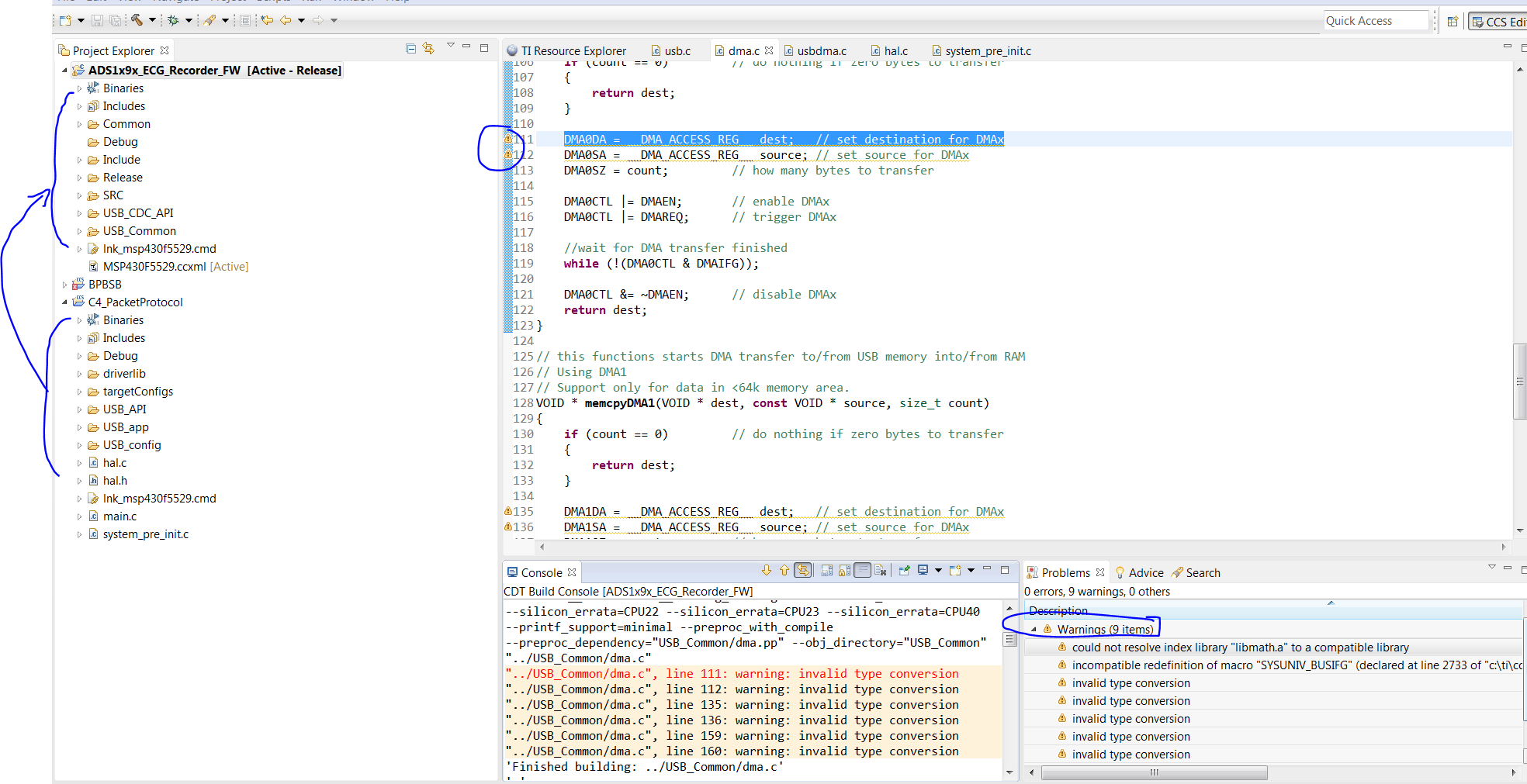

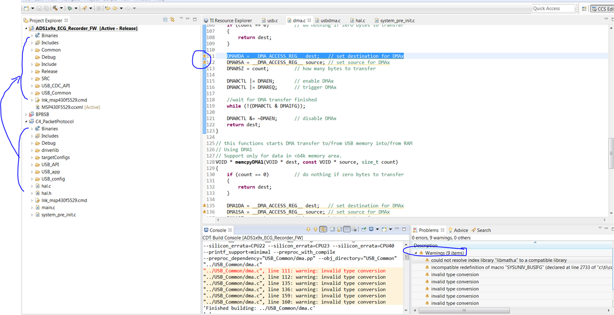

  • Dear E2E TI team,
    I followed this E2E Ti post : "Compiling issue(s) of ADS1x9x ECG Recorder FW project"  And it work perfectly ! :).
    Now I am trying to clean 9 warning , I think that related to the USB old libraries and "libmath.a", I think we should update the old USB libraries, What do you think ? could you help me ?
    (see screenshot below) :
    Haithem.
  • Hi Haithem,
    I am happy to hear that you found the older post and got the ADS1292 project to compile. I'll talk with the Embedded Processing folks and see if they have any newer libraries.

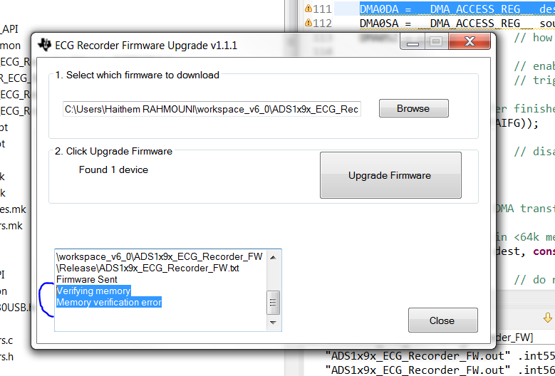

  • Hi Tom,
    I am sorry for this delayed reply! I have just come back from business trip.
    Responding to your question, we ultimately want to familiarize with ADS1292RECG EVM firmware in order modify the existing code to build and develop our own application for own hardware that has the same MCU and we will add BLE module and other peripherals.
    We have received the EVM and when we tried to upgrade original Firmware provided by Texas with USB using BSL application we have an error message  :
    “Verifying memory
    Memory verification error”
    Could you please help us to unblock the situation? because the EVM didn't work after that ! (please see Annex below for more details).
    Annex :
    BSL application screenshot :
    Full BSL application terminal messages :
    Starting
    Password Sent Successfully
    Sending RAM BSL v00.05.04.34
    Done RAM BSL v00.05.04.34
    Erasing memory segments
    Sending C:\Users\Haithem RAHMOUNI\workspace_v6_0\ADS1x9x_ECG_Recorder_FW\Release\ADS1x9x_ECG_Recorder_FW.txt
    Firmware Sent
    Verifying memory
    Note that we have followed the EVM user guide in upgrade operation and we have used the "FW upgrade" button by keeping it pressed when we strat upgrade operation.
    Haithem.

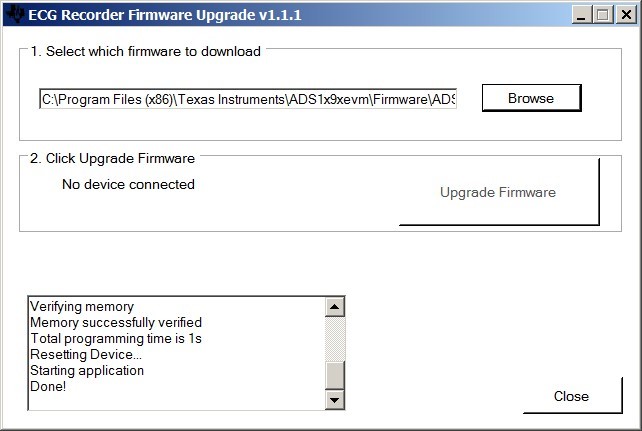

  • Hi Haithem,
    Did you try to load the original file that was installed on your PC when you installed the ADS129xEVM GUI?  It should be located under C:\Program Files(x86) \ Texas Instruments \ ADS1x9xevm \ Firmware.  The file is ADS1x9x_ECG_Recorder_FW_V1_12.txt.
    @4400

  • Hi Tom,
    Thank you for your quick reply !
    We confirm that we have loaded the original file provided by Texas and installed with the ADS129xEVM GUI ( exactly the same file that you have attached in your last message).
    Could you please do the test and check from your side ?
    Haithem.
  • Hummm...it worked just fine for me.  Are you sure you have not tried to load a modified file?
  • Hi Tom,
    I am sure that I am using the original file! I even uninstalled and reinstalled the ADS1292EVM_SW_v1.11  software without success.
    The trouble that the upgrade process takes for me four munites to erase, sent the new file and to verify the memory, at the end of the operation I have memory verification Error. and for you, the operation take only 1s, with done !
    I doubt that I didn't follow the correct steps for the firmware upgrade process, could you please describe to me what you did to upgrade the firmware? have you used the upgrade firmware button? if yes, how you have used it, before launch the upgrade process and keep it hold down or after launching the upgrade process?
    Haithem.
  • Hi Haithem,
    So here is what I did:
    1.) plug the ADS1292R evm into my laptop via USB
    2.) start the ADS1x9x ECG-FE GUI
    3.) click 'File -> Load Firmware' (At this point in the process, the ECG Recorder Firmware Upgrade v1.1.1 interface comes up by itself, so you should not have to do anything)
    4.) In the firmware updater, browse to c:\program files(x86)\Texas Instruments\ADS1x9xevm\Firmware and pick the ADS1x9x_ECG_Recorder_V1_12.txt file - then click 'open'
    5.) back in the updater window, click Upgrade Firmware
    At that point, the updater disconnects (resets the MSP430) and when you 'Close' the updater, the ADS1x9x ECG-FE GUI resets. Here is the BSL log:
    Starting
    Mass erase occured!
    Sending C:\Program Files (x86)\Texas Instruments\ADS1x9xevm\Firmware\ADS1x9x_ECG_Recorder_FW_V1_12.txt
    Firmware Sent
    Verifying memory
    Memory successfully verified
    Total programming time is 1s
    Resetting Device...
    Starting application
    Done!
    I don't know what you mean by "and keep it hold down" in your last post. What are you holding down? If it's the reset button on the ADS1292R EVM, that's probably what is going wrong. I don't touch the board through this process. The SW resets the board on its own.
  • Hi Tom,
    I changed the PC and it's working perfectly ! the problem is on my PC, although it a professional workstation! I am sorry for that!
