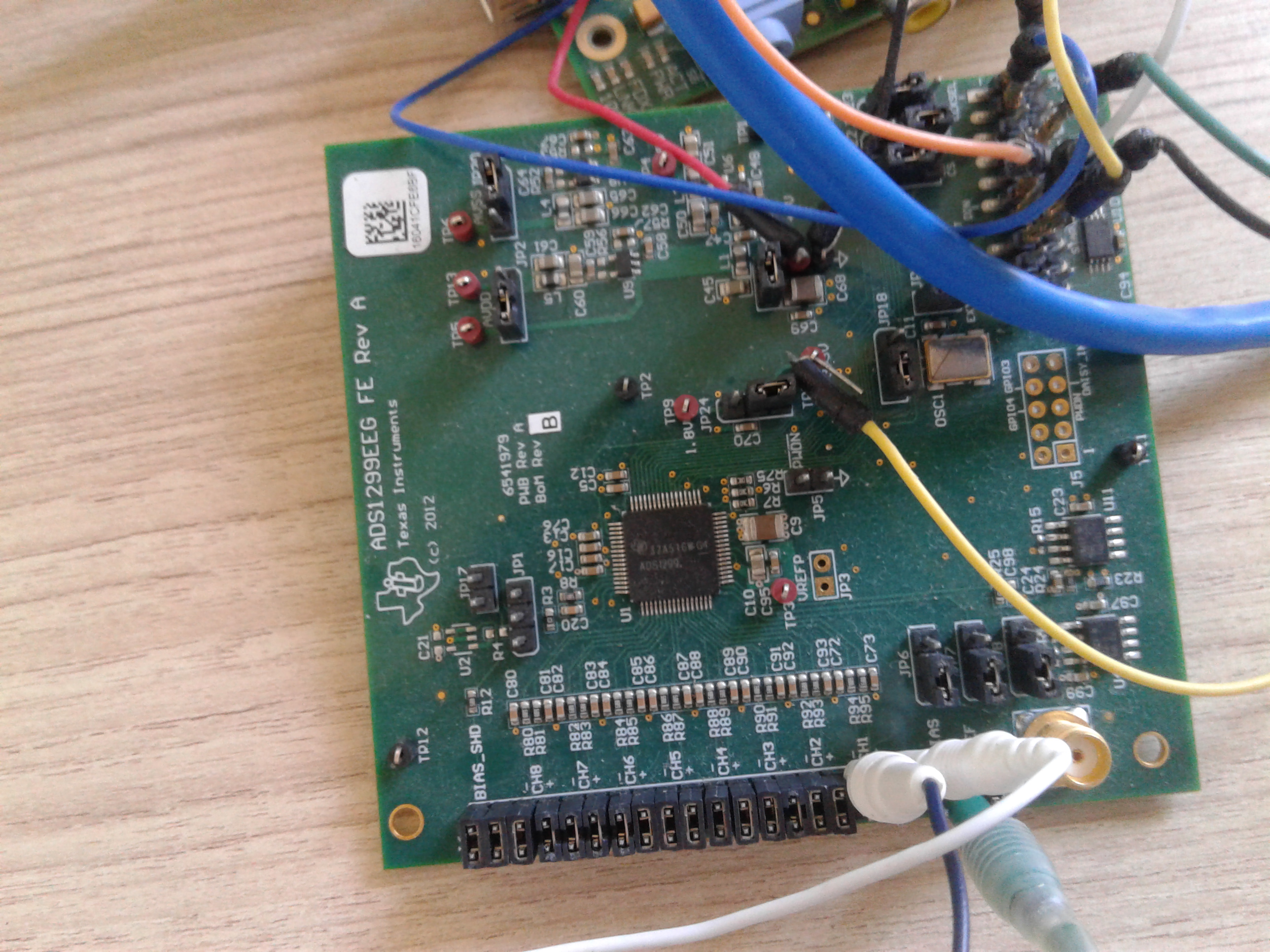

Hi, I'm developing a simple prototype to read EMG signals using the ADS1299 Dev KIT as a close relative has ALS, I plan to test the dev kit to see the viability to use the ads1299 on this project family funded. I'm not testing it on the patient because of the risks and the term of service so we are generating 10 to 20 mvolts to check whether the readings are right.
I've decoupled the bottom board and am using the top one interfaced with a raspberry.

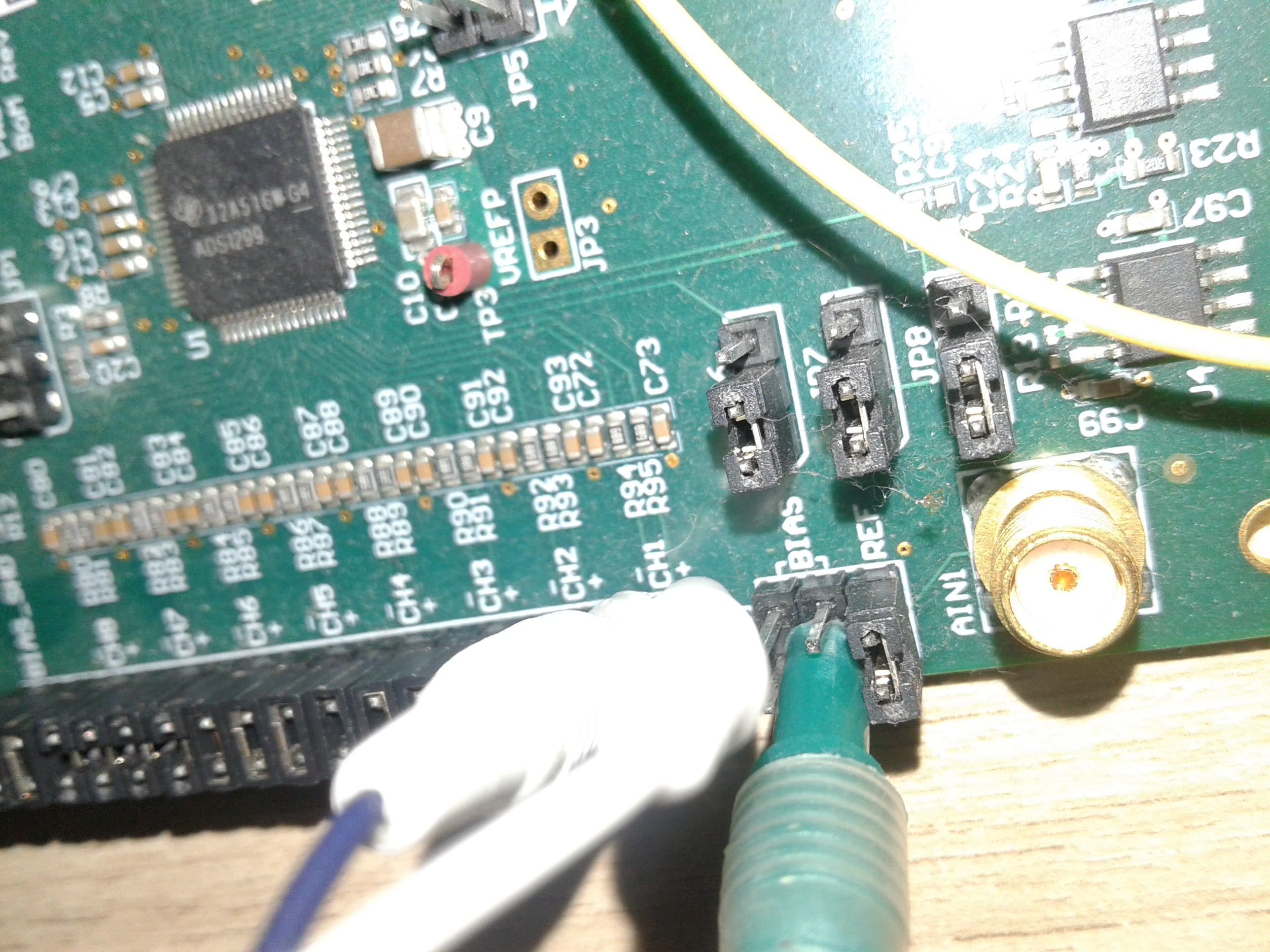

I have the SPI communication working, battery feeding working but I need some guidance on how to set up the jumpers and where to place the electrodes to optimize it for EMG not EEG.
I'm using only 3 electrodes being 1 a BIAS electrode (which I don't know where to place), 2 electrodes connected to channel 1 INP1 AND INN1.  All the other channel pins are grounded with jumpers.
So basically I just need a review if the jumpers/electrodes are in the right places? And where do I use the bias electrode (green one) ?
Thank you so much, and I'm sorry if it doesn't make sense, I never thought I'd face myself working with something so complicated :\

  • Hi Rodrigo,
    Thanks for your post!
    You're on the right track by using a signal source with known, reliable output as a starting point. Make sure that the common-mode voltage (Vcm) is within the acceptable input range of the PGA (see equation 4 on page 23 of the datasheet). Typically, it's easiest to set this to mid supply. The differential voltage (between INxP and INxN) can swing around Vcm from +Vref/Gain to -Vref/Gain. In a real-world application, this is the purpose of the BIAS electrode, which drives the body with a DC bias voltage in addition to a common-mode mode cancellation signal.
    We are more than happy to review your register settings and EVM jumper configuration as you evaluate the ADS1299; however, since we really are not the medical experts, we cannot provide any guidance on the best electrode placement for your application (most of our customers know this much better than we do :) ).
    If you can provide your data in an x-y plot format with units labeled on the axes, it would be much easier to interpret the data you are collecting.
