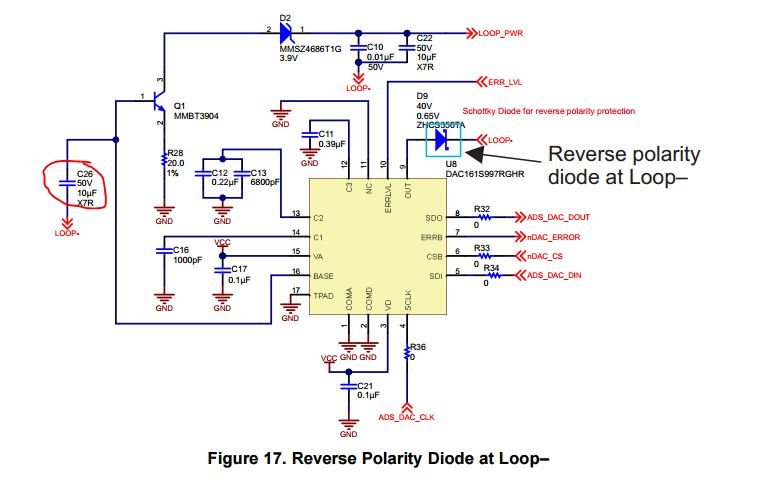

i'm having problems with making the DAC161S997 working properly. My design is the same as in the typical application in the datasheet of the device, but the communication with the device isn't working well, i have the oscilloscope decoding well the commands on the MOSI line but the DAC still not providing the correct value of the current in the loop. Is there any special manipulation with the SPI to make it work ??

  • unfortunately the DAC161S997 doesn't respond to the SPI commands, either for writing the desired current value or for reading internal registers( spaciallay the STATUS register). Besides the SPI specifications(24 clock signals and the data format) is there any special manipulation with it ?
  • Thank  you Matthew Sauceda for your help.
    problem solved !!!!
    The DAC161S997 now is responding to every current value that i send and it is functioning properly. The problem was this capacitor in the base of the transistor and the loop- in the design of the 2-wire transmitter of TI designs () after i have removed it everything is normal.

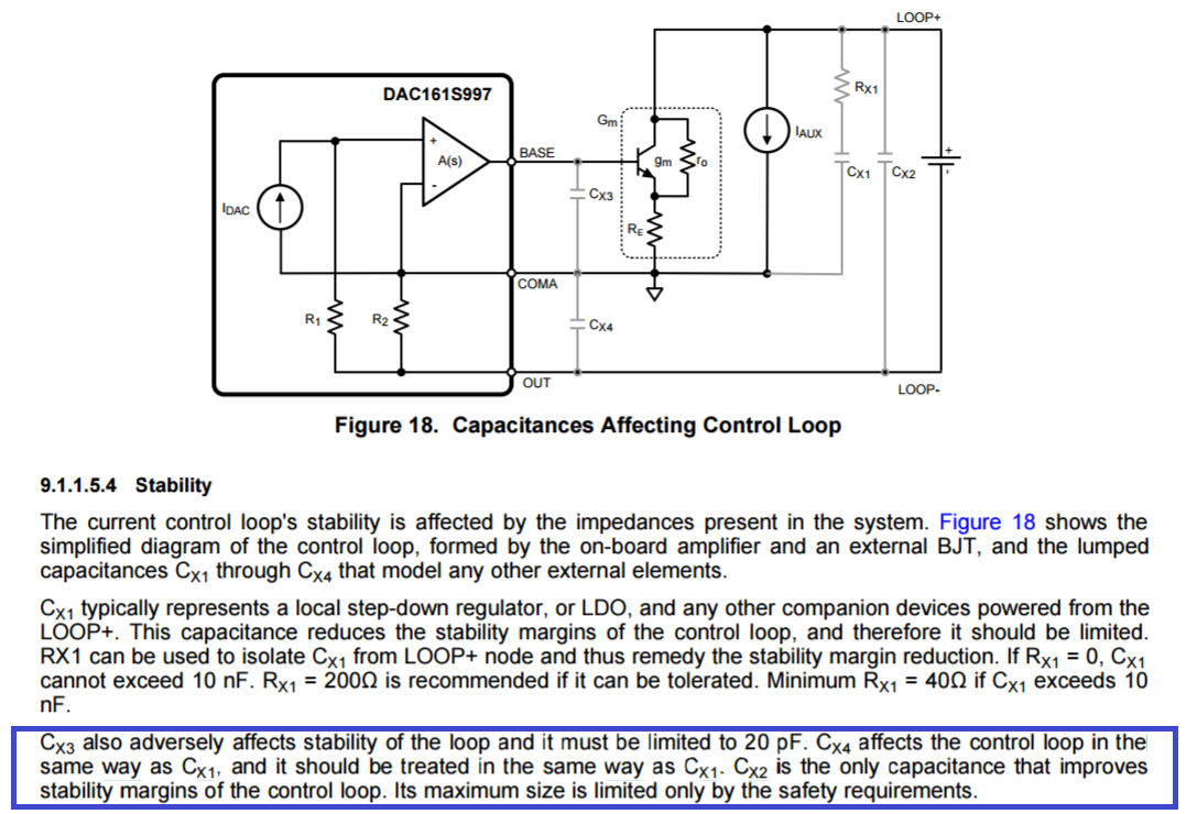

    That's great news!  It may be a typo in literature, but when in doubt always refer to the datasheet :)  The datasheet does state that the capacitance on the BASE pin should not exceed 20pF (pg 22 of the DS), as anything larger may affect the stability of the system.
