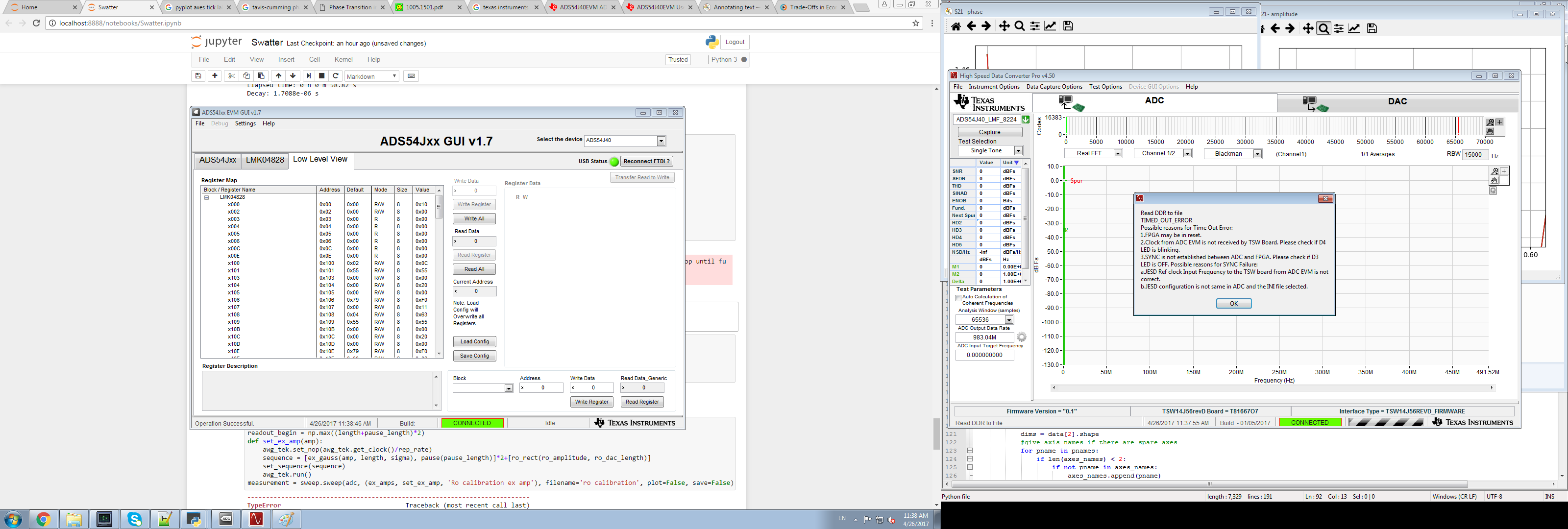

My customer bought four development kits: TSW14J56EVM + ADS54J40EVM
Three dev kits work correctly.

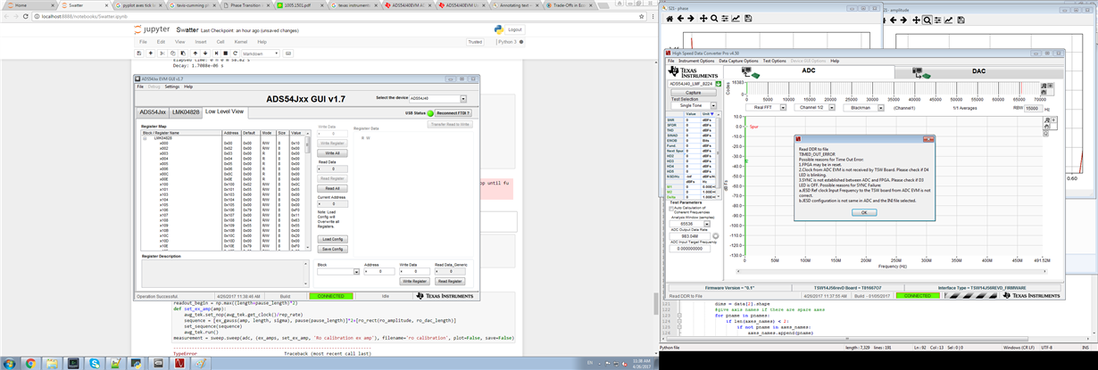

On one of four TSW14J56EVM boards when data is collected  an error occurs – screenshot in attach.
On the board is not working two status LED D6 and D7 is “On”, D8 is "Off", and D4 – is blinking
As I understood from User’s Guide for TSW14J56EVM problem wth initialization DDR3…
How to solve this problem and return the workability of TSW14J56 board?
  • Hi Maxim,
    If LED D7 and D6 are on then there is an issue with the DDR memory. When the firmware is loaded, the first thing it does is a DDR memory test. If the memory is bad I would suggest returning the board to your vendor for replacement.
    Ken
