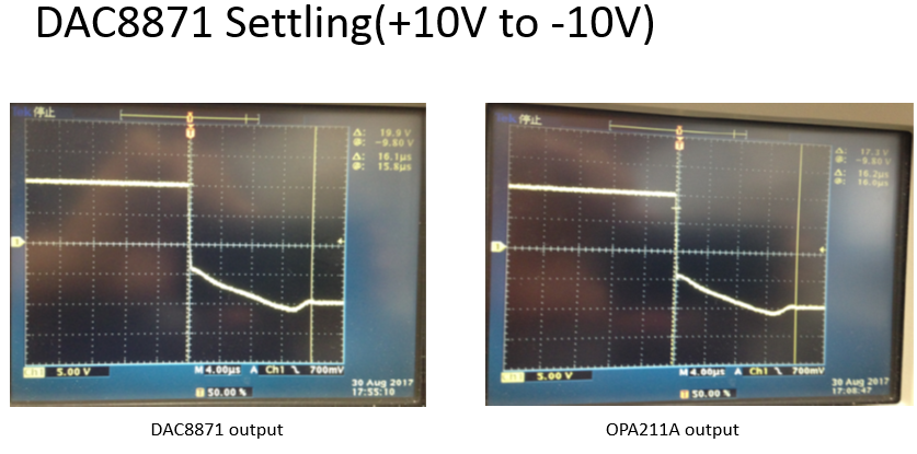

In the customer, the settling time from +10V to -10V is about 15us.
-10V to 10V settling time is about 1us.
In the datasheet, both settling time is about 1us.
Could you please let me know this reason and how to improvement this operation?
Their opamp is same with DAC8871EVM. There is difference the filter or compensation only.
I can send the schematics if you contacted the following my e-mail.

    These waveform measured at DAC output pin.
    Also they use compensation capacitor 3pf to OPA211 feedback resistor.
    In the datasheet there is the settling time waveform as figure 35 and 36.
    And these settling time is about 1us.
    Could you please let me know the measurement schematics and setting of these data?
    In the DAC8871EVM, the OPA211 feedback if resistor 6.2kohm only. There is no compensation capacitor.
    Does this EVM operate stably?

    Also they measured the waveform at DAC output and Opamp output.
    As a result the waveform is almost same.
    Thus I thought that the problem was not occurred due to OPAmp.
    Since the DAC output is unbeffered , is this problem occured due to OPamp?

    I attache the reference buffer schematics and waveform of VREFL-F and Vout.
    Our customer change the filter value and get the waveform.
    The problem is improved but not solved yet.
    dac8871.pdf
    I requested to change the filter as the following.
    1.Left side C: DNI, Right side C:1nF
    2.Left side C: DNI, Right side C:1~10uF
    3.filter CR removed
    I would appreciate it if you would recommend other method to solve this issue if there is.
    Ryuji
