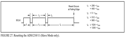

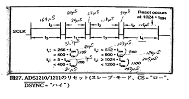

Let me post as below about reset timing of ADS1210 the other day.
https://e2e.ti.com/support/data_converters/precision_data_converters/f/73/p/627987/2315621#2315621

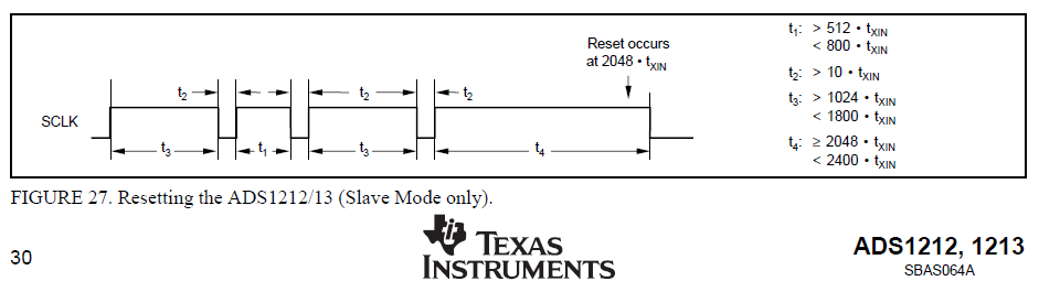

After that, I also have studied other similar devices, ADS1212, ADS1216.
As a result I found that the reset timing of ADS1212 is similar to ADS1210's old reset timing.
And the reset timing of ADS1216 is similar to ADS1210's new timing.
The RTM of ADS1212 is around 1996, the same as ADS1210.
On the other hand, the RTM of ADS1216 is around 2000, the year when BB was moved to TI.
It seems to be interesting fact...
<Old reset timing of ADS1210>
<New reset timing of ADS1210>
<Reset timing of ADS1212, similar to old reset timing of ADS1210>
<Reset timing of ADS1216, similar to new reset timing of ADS1210>
I hope that this information may be help to understand the reason why the reset timing was changed.
