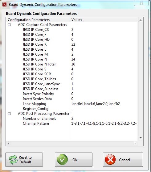

I'm using a TSW54J60EVM and a TSW14J56EVM to evaluate the ADS54J60 and the LMH6401.  Using High-Speed Data Converter Pro v4.50 with the default firmware and configuration files, I get the following configuration parameters :
JESD IP Core_CS = 2
JESD IP Core_N = 14
JESD IP Core_Ntotal = 16
Does it mean the board is in 14-bit mode with 2 control bits?
