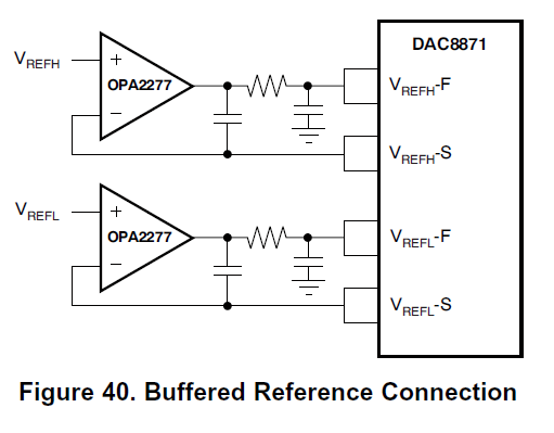

Figure 40 in the datasheet shows buffer driven reference inputs with an RC low-pass on both VREFH-F and VREFL-F. Can you please provide guidance regarding appropriate values for these components as well as the feedback capacitor on each OPA2277 op-amp? I am constrained on the size of the resistor, as I want to minimize the divider drop into the 7.5kohm input resistance. It is interesting to note that the evaluation board for the DAC8871 does not implement this topology for the reference inputs.
