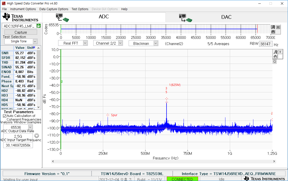

I am designed ADC32RF45EVM (PCB REV E) board and TSW14J56 (PCB REV E) Board.
Set up the H/W below
1. ADC32RF45EVM is bypass mode (14bit)
1. Fs = 2500 MHz, Fin = 1875 MHz is result below
2. Fs = 2500 MHz, Fin = 1875.1 MHz is result below
only 1875 MHz is not seem in HSDC Pro v4.80.
it is center frequency of 2st nyquist zone.
2500(Fs) / 4 * 3 = 1875 MHz
what is the problem?
is this a my mistake?
Kim
  • Kim,
    this is due to the DC corrector inside device notching the n*fs/8 frequencies, hence your signal being attenuated. If you need to sample a signal at exactly this frequency you might try modifying the sample rate so the signall frequency won't fall at  n*fs/8.
