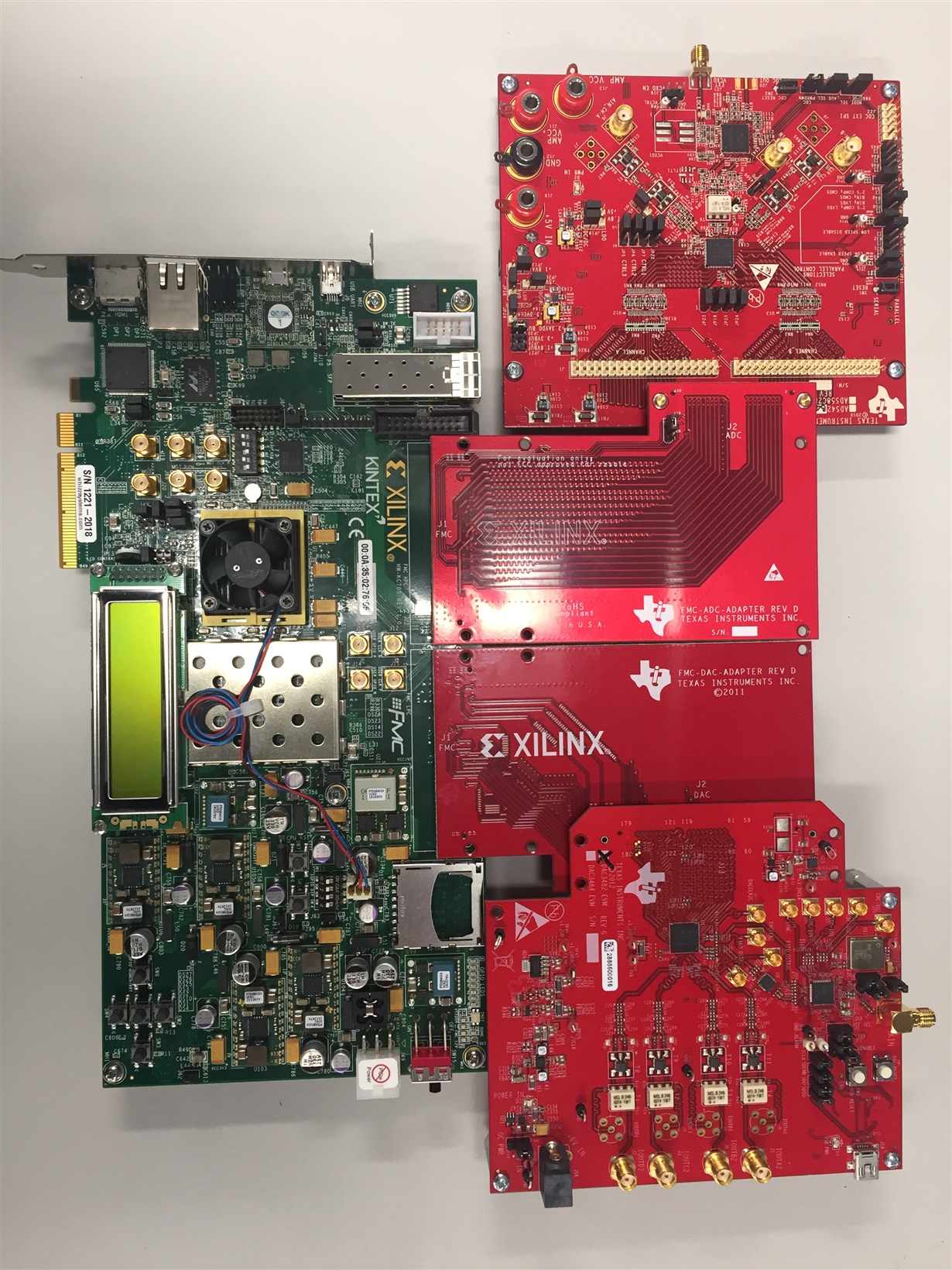

  • Thanks, Brian.
    I will wait for the source code. Before that I would like to know a simple thing: Can you tell me if both (ADC and DAC adapters) are  pin compatible with KC705 board?
    With which connector? HPC, LPC or both?
    Can you take those boards and try to insert both into the same KC705 board?
    If you could publish a picture of both inserted into this board, I'll be most grateful.
    Thanks for your support,
    Avi
  • Hello Avi,
    I was able to confirm the mechanical fit of the KC705 to the adapter boards and EVMs.  The adapter cards use the 'LPC' configuration of the FMC connector, so they are compatible with both FMC connectors on the KC705.
    There is a mechanical interference with a standoff and the DAC board.  You will need to remove a standoff.
    Finally, the standoff heights must be adjusted.  The FMC and HSMC connectors perform well if the boards match height when mated, but mismatch can cause intermittent contact problems.
    I think the other concern about mismatch/interference has been addressed with a BOM change on the DAC board HSMC connector.  Please see this post for explanation.
    https://e2e.ti.com/support/data_converters/high_speed_data_converters/w/design_notes/3316.dac348x-hsmc-connectors
    The board you order will have the correct connector on it.
    Brian

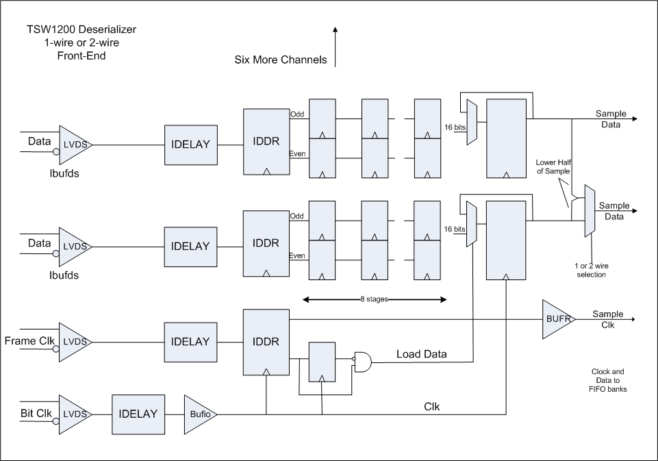

  • Avi,
    I have found another resource that might be helpful. Xilinx has an XAPP866 literature and example project for interfacing with one of our Serial LVDS devices. It goes through the design process, and how to align the data.
    The ADS4249 would be configured as DDR (sample on both clock edges), so there would be some modification required, but it might be a more straight-forward port than the Altera code.
    The Literature and Project are available on Xilinx.com and search XAPP866. You will have to log in to Xilinx to download the code.
    Brian

  • Hi Brian,
    The XAPP866 application note is not applicable for me from the following reasons:
    1. They say: "Speeds of up to 125 Megasamples per second (MSPS)". ADS4249 is 250 Msamples/sec - quite a different timing.
    2. It is serial LVDS. My question was about Parallel LVDS which is used to connect TI boards to Xilinx boards.
    3. On serial LVDS the bandwidth is about 20 times higher. Do you think it would work with all of that distance between the ADC and the Xilinx board? (with TI adapter boards in the midle)
    I doubt it.
