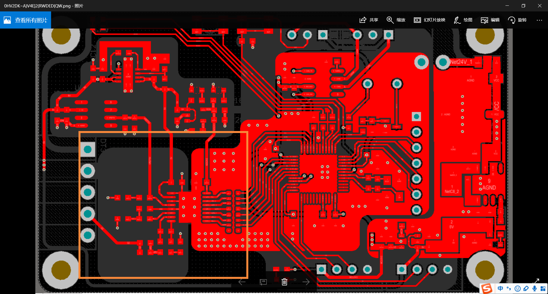

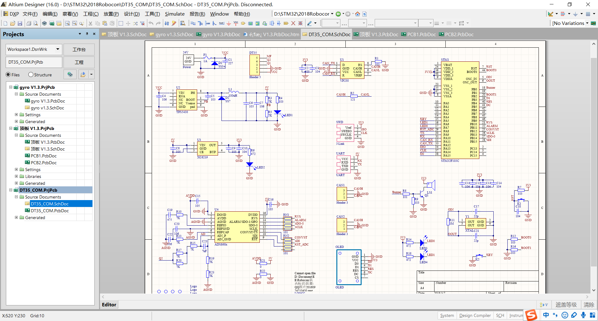

  • Hi Biao,

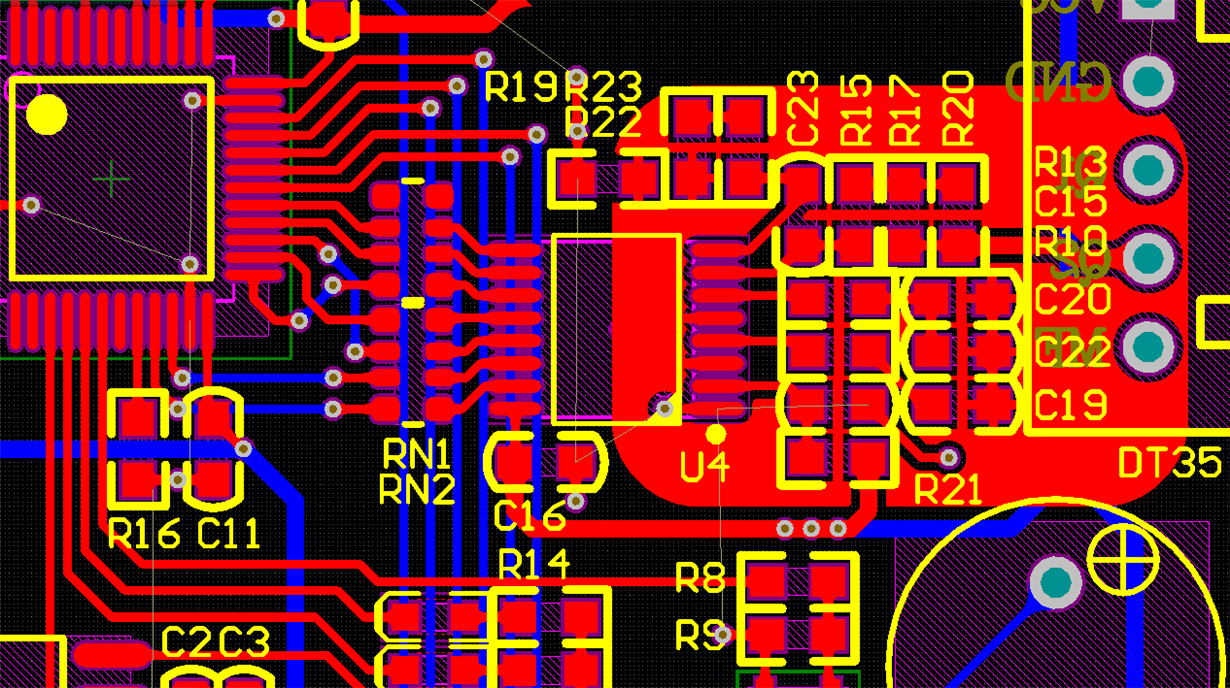

    Your schematic looks fine for me, but there are some concerns:

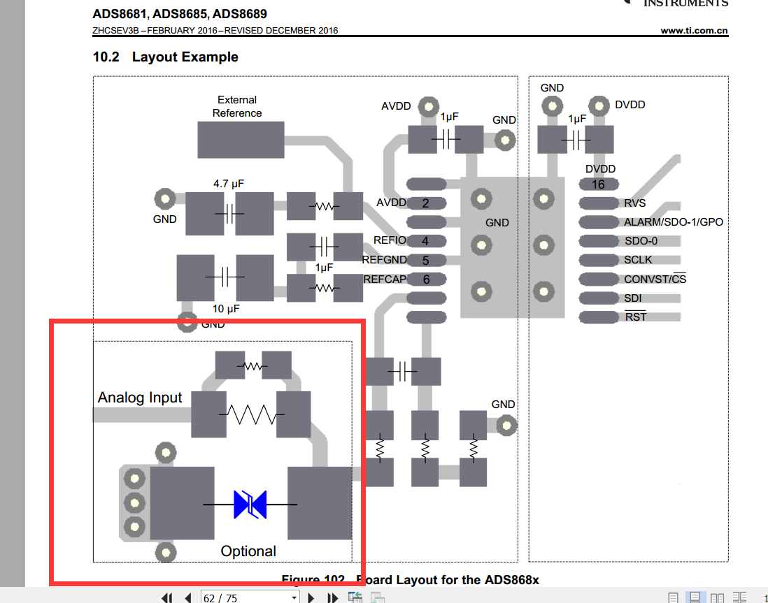

    1.  Your are splitting the ground and your ground connection point by R22 is far from ADC, also you are using only two-layer pcb board and there is very small analog ground area. You have to make sure the voltage difference between GND and AGND/REFGND is less than +/-300mV, so a solid ground plane is strongly recommended and this is also mentioned in datasheet.
    2.  Two-Layer pcb layout is not easy to achieve 16-bit ADC's performance, also your board size is small and all circuits including DC-DC and MCU digital circuit are put together. It's important to have a clean layout to avoid any interference from digital/power to analog circuit.
    3.  ADC's AVDD is used for internal signal acquisition and conversion, so it's important to have a clean and well-bypassed power supply. A low noise LDO is a good solution to provide a supply to the ADC, for example, TPS7A47xx, this is a very common device to be used in our EVM boards.
    Please refer to Layout Guidelines for more details in ADS8689 datasheet page 61.
    Except above layout suggestions, can you please let us know the value for resistors and capacitors in your schematic? also please upload your timing screenshot from a scope so that we can check if your timing is correct, like Figure 3 in datasheet.

  • Hi Biao,
    When you set ADC input range to 2.5xVref( 0-10.24v), if the conversion code you got is 16383, the corresponding voltage is around 2.56V [(16383/65526)*10.24]. I suggest you to do a test without input range change in case your digital signal's timing has any potential issue, after power up the ADC, the default input range is ±3 × VREF(±12.288V for internal 4.096V reference), please upload your conversion data file and I can check for you.
    Please notice that:
    1. Don't use power supply as input test signal because the code will not be stable for noisy supply.
    2. Let me know the value of your resistors and capacitor(input) in your schematic.
    3. Upload your timing screenshot from a scope for SCLK,/CS,SDO and SDI, so I can check if your timing is correct.
    By the way, as I mentioned in previous reply, your Two-Layer pcb layout board and your splitting the ground will be a challenge to achieve the performance on ADS8689 even the function will work after you do above test. Please re-design you pcb board if it's possible.
    Thanks.
    Best regards
    Dale

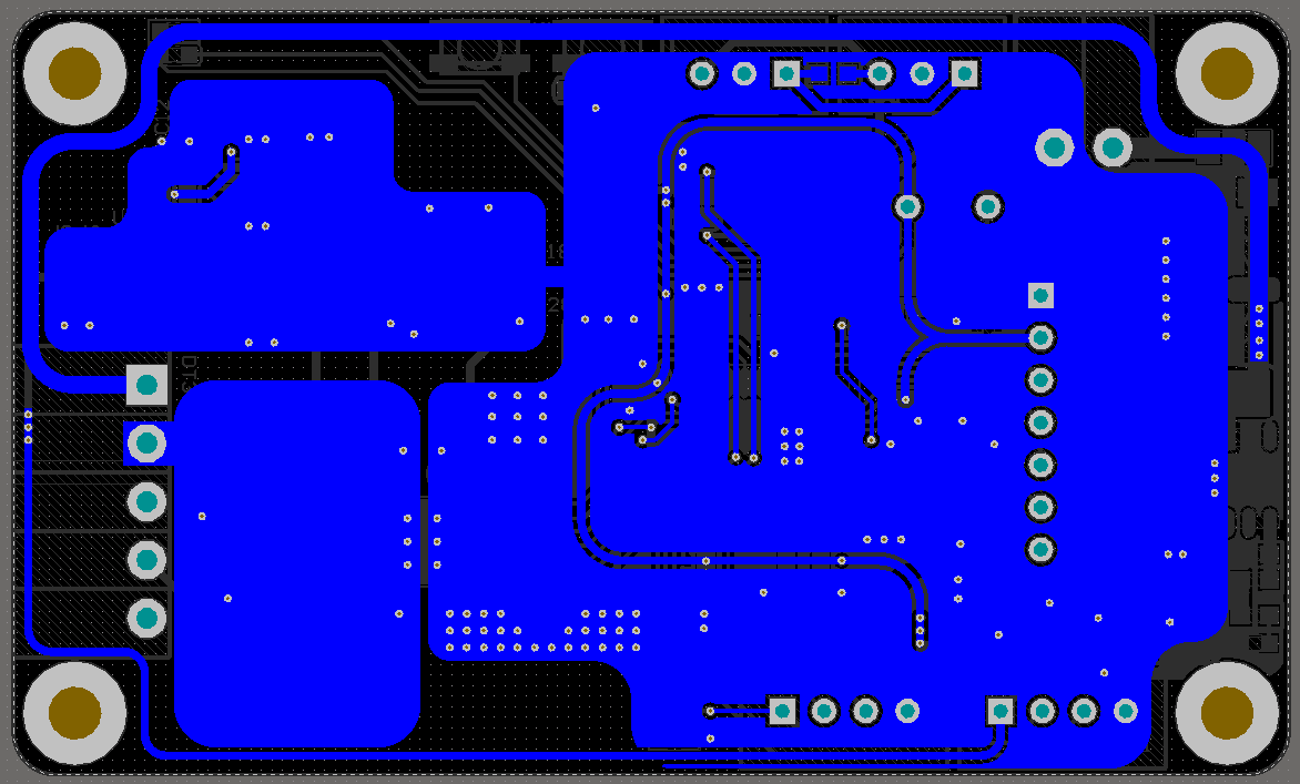

  • I re-design my pcb board now,and i do not  have condition test timing ,i just a student .can i use the gnd as input test signal?

    I re-design a pcb ,how about it ? Thanks.  Thanks.
