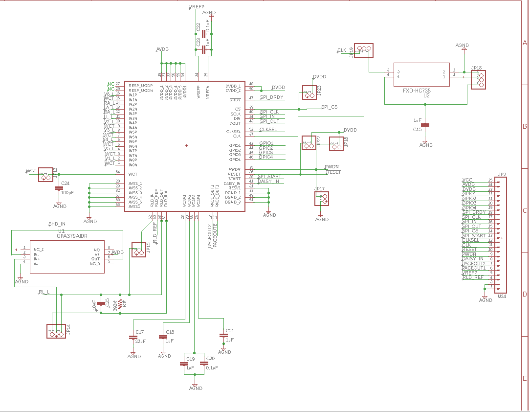

Here is my complete Schematic for ADS1298, please tell me weather this is correct or any kind of limitation were there.

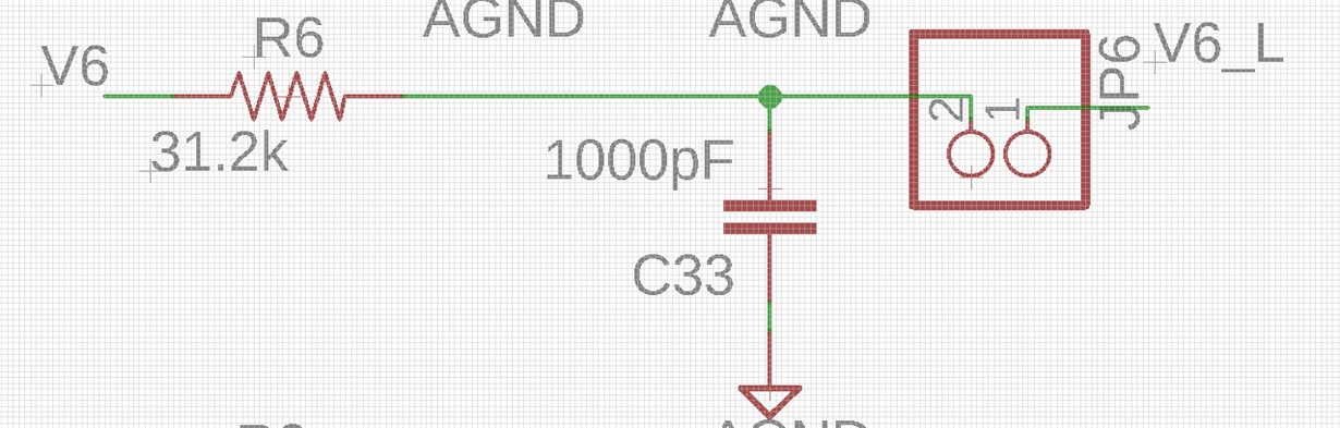

here is my Front end anti-aliasing Filter having cutt off of 5.12khz which give enough attenuation at Fmod=512khz.
Here is schematic of ADS1298/ADS1198

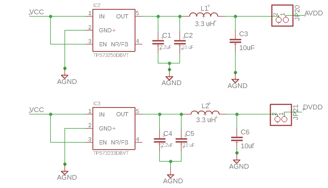

And here is power supply design
