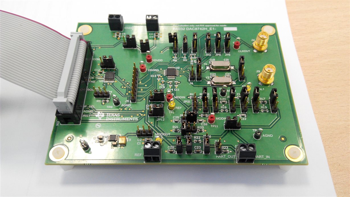

Our customer's playing with DAC8742HEVM.
They try to simulate a modulation on the modem output. But there is no signal on the output line of IC DAC8742 (signal MODOUT, the testpoint on EVM for oscilloscope probe is TP13).
They use  TI GIU for this EVM. The modulation simulation they manage by pushing “Generate Write” button (see the photo).
Modem configuration is: Internal reference; internal filter mode; hart interface, internal oscillator, UART interface (connecting with MCU).
What do they do wrong? Why is there no modulation?

  • Hi Anastasia,
    Based on the GUI photo you provided, the internal reference does not appear to be enabled. The internal reference must be enabled by clicking the 'precision reference' block in the block diagram.
    Garrett

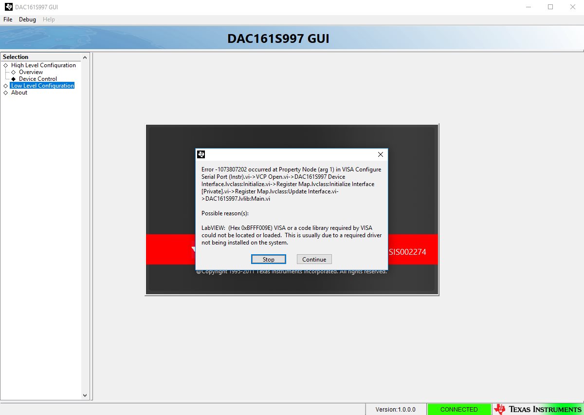

    But there is new problem. They connect DAC8740 EVM and DAC161S997.
    There comes an error when they connect EVM DAC161S997 with DAC161S997 GUI (please look at attached slide). They tried to reinstall GUI (for the first time the program didn't recognize port). After reinstallation the error came.

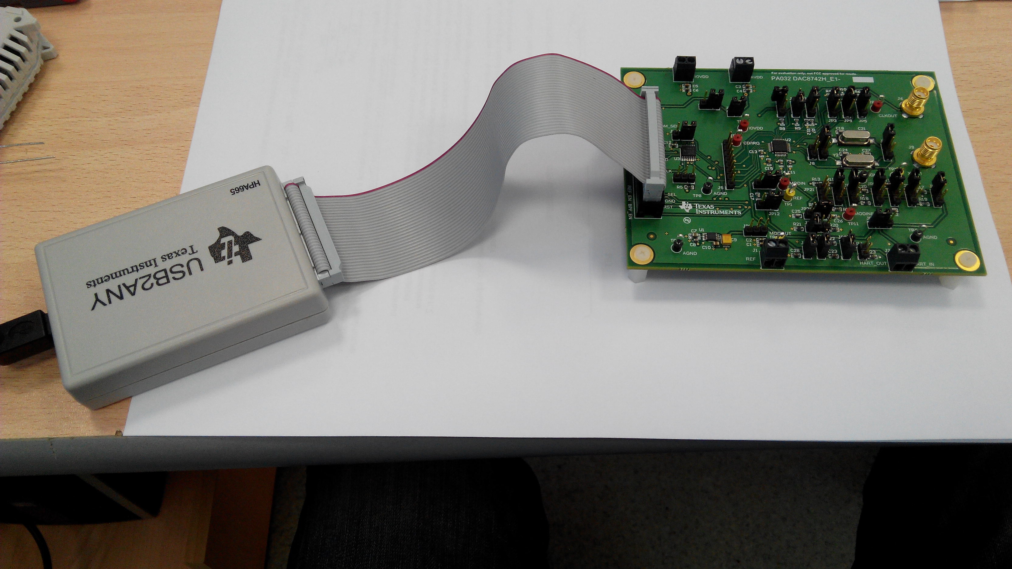

    Here below there is photo EVMs connected together (AGND line of  DAC8742H EVM is connected with COM line of DAC161S997 EVM).

    Were they able to solve the error with the EVM software? It looks like a driver or dependency is missing which could be related to the OS or other software installed. The EVM software is compatible with Windows 10. If they cannot launch the EVM software how are they applying a HART signal to the DAC161S997? Maybe they could try installing on another computer.

    First off, the software error you were seeing is caused by trying to launch both EVM's software on the same computer. This error can be solved by simply using two computers, one for each EVM.

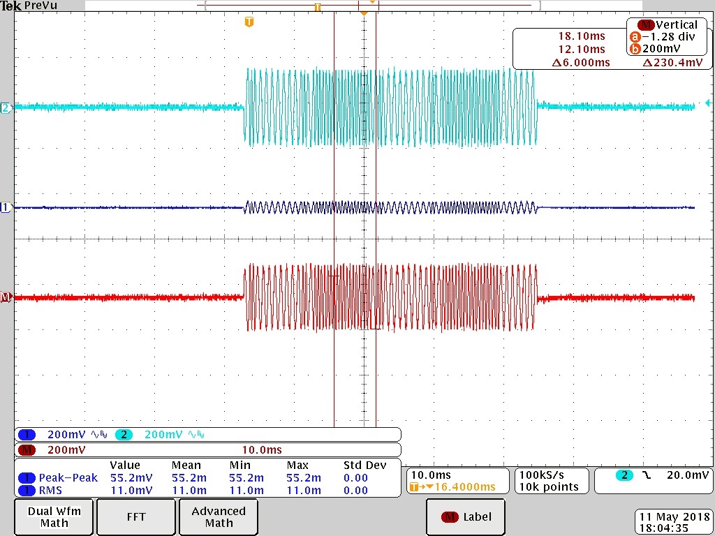

    3. Connect GND of DAC874xH EVM to COM of DAC161S997 EVM and MODOUT to test point H9 .
    4. In DAC874xH software: Enable reference, enable BPF, and type some data to transmit then click 'generate read'.
    5. Measure the voltage across the load resistor to see the HART signal. Be careful to avoid ground loops. When I initially tried to measure with the GND of the oscilloscope connected to the low side of the sense resistor it created a ground loop with the computer I was using that was also plugged into AC power. To solve this issue I connected the scope ground to COM and measured across the resistor with two separate channels.
    Below is the result:
    Channel 1 is the positive side of the load resistor while Channel 2 is the negative side. M is (CH 1. - CH 2.) voltage across load resistor. The voltage is about 240mVpp across ~250ohm resistor or ~1mApp.
