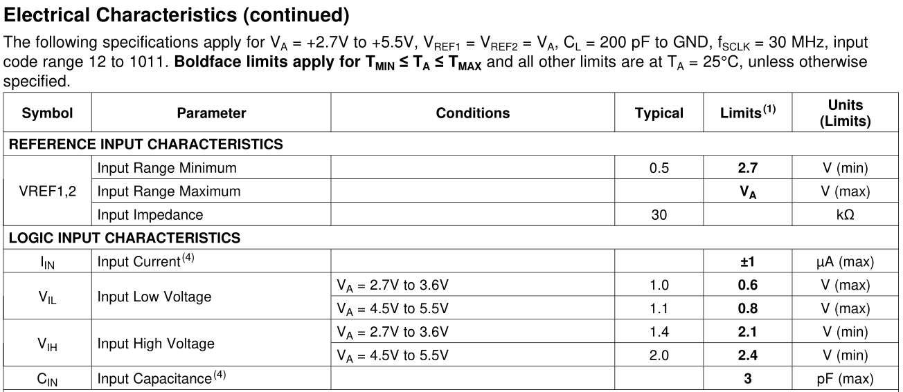

Good evening,
I'm planning on using the DAC108S085 in my design, and just wanted to confirm my understanding given some information presented in the datasheet. My DAC will have Va = 5V, to provide a 0-~5V analogue output across each of the 8 output channels. The DAC will interface with my 3V3 MCU, so I've been thinking about using a TXB0104 logic level shifter to accommodate the different logic levels. However, on closer inspection of the DAC datasheet, I've found the below:
Is my understanding correct (given the above) that 3V3 SPI signals (CLK, MOSI and CS/SYNC) will work as intended with the DAC even if it's a 5V device? My MCU's minimum HIGH output voltage is ~2.9V, and it's maximum LOW output voltage is ~0.4V. Would the reliability of this interface be improved at all by using external 3V3 pullups at the DAC?
Finally, I will not be using the DOUT functionality of the DAC; can this pin be left unconnected, or should it be pulled down to GND?
