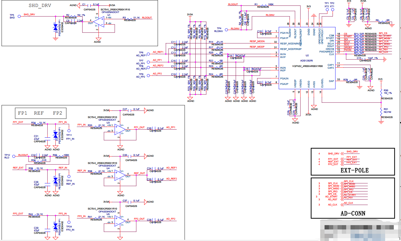

Dear TI Experts,
My customer is evaluating ADS1292R in a new project, they can hardly detect lead-off, could you kindly help to review below HW and SW and give some advice for this case? Thanks a lot.

  • Hi Bruce,
    Sure thing! We can take a look over the ADS1292R register details and schematic snips for you. In the meantime though, can you let us know what "hardly detect lead-off" means here? Is it slow to respond or does that mean that don't get the comparator function to work at all?
  • Dear Tom,
    Thanks for your help, in most cases, my customer don't get the lead-off function to work at all. Occasionally, it works.

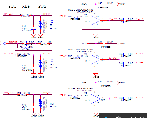

  • Hi Bruce,
    Your electrode inputs appear to be AC-coupled. DC lead-off detection will not work.
    If the RLD output is being used to bias the subject, then you can replace the series capacitors with 0-ohm resistors on the ECG channels. You will need to keep Channel 1 AC-coupled if it is used for respiration measurements.
  • Dear Ryan,
    Thanks a lot for your support. Yes, at first time, the series capacitors caused DC Lead-off mode detaction failed. Follow your advice, customer tried to change to the AC Lead-off mode , however , it failed again, below are the result and the configration , could you kindly help to check again?

  • Bruce,
    The comparators are used for DC lead-off detection only. AC lead-off is determined by post-processing the raw data and analyzing the magnitude of the signal at the lead-off current frequency.
    Please review the AC Lead-Off Section on page 53 of the data sheet.
    In addition, you may find the following application note helpful as well to learn the differences between the two methods:
    http://www.ti.com/lit/an/sbaa196a/sbaa196a.pdf

  • Dear TI Experts,
            We change to the AC Lead-off mode,electrode 1 connected to REF_EXT,electrode 2 connected to FP2_EXT.Measure the channel 2,it was found that the success of the test was related to the contact time between electrode 1 and skin,Describe the following:
    1.At first,electrode 1 and electrode 2 maintain good contact with the skin.At this point,the LOFF_STAT[4:0] value is normal whether the electrode 1 or electrode 2 falls off,or both electrodes fall off simultaneously.
    Electrode 1 falls:LOFF_STAT[4:0]=01000;
    Electrode 2 falls:LOFF_STAT[4:0]=00100;
    Electrode 1 and electrode 2 fall off simultaneously:LOFF_STAT[4:0]=10000;
    2. But, if the contact time between electrode 1 and skin is longer than 15 seconds, AC Lead-off results will fail, and the LOFF_STAT [4:0] value will remain "10000". Unless the electrode 1 is kept away from the human skin for about 10 seconds at this time, and then the electrode 1 is re-maintained in good contact with the human body, it will return to the sucess state of detection. This abnormality is very regular, as long as the electrode 1 keeps in good contact with the body for more than 15 seconds, this will happen. But electrode 2 will not have this abnormal condition.
    Based on the above phenomenon,we want to know:
    1.If the comparator can only be used in DC Lead-off mode, why is LOFF_STAT [4:0] valid when we set it to AC Lead-off mode?
    2.In the AC Lead-off mode, although the value of LOFF_STAT[4:0] is detected effectively. But why does electrode 1 keep in good contact with the skin once more than 15 seconds will appear abnormal detection of this rule.
