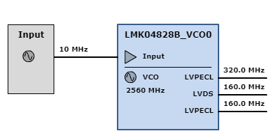

    If I go with the lmk04828 do I need an external VCO? I used TI's webench which looks very simple. It suggests a ref clk at 10 MHz and an internal  VCO at 2560 MHz, can that frequency be achieved?
    There are a lot of input clock pins,  (CLKin1, CLKin1* etc) which one do I connect the 10 MHz to, and does the 10 MHz come from the FPGA?
    how about the SDCLK_out, do I need those for the DAC and ADC?
