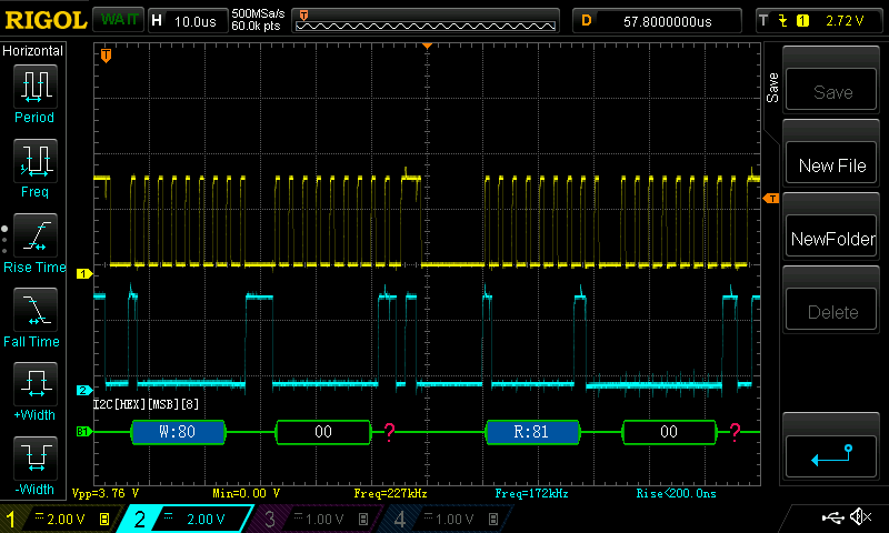

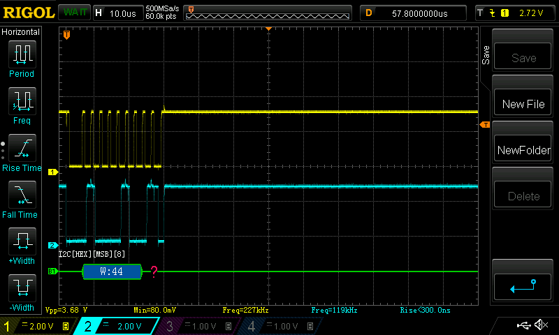

  • Bob,
    Here is an I2C transaction with a valid device on the bus:
    Here is at the address programmed for the ADS122C04 (A0 = A1 = DVDD):
    And here is where the device seems to attempt to respond at a totally different address not listed in the datasheet:
    You can see the absence of ACKS
  • Hi Luke,
    Thanks for the scope shots. In the datasheet for the ADS122C04 there is Table 14 on page 35. This shows that for both address inputs connected to DVDD the I2C address is 100 0101 (0x45). Your scope shot is showing something different in two ways. The first is the address is implemented incorrectly and second it would appear you are using 100 0100 (0x44).
    The implementation for I2C addressing of the device is not writing 0x45 to the device. The actual addressing for I2C with the ADS122C04 is 7-bit address shifted left 1 followed by the R/W bit. The correct format when transmitted would appear as 1000 1010 ( 0x8A) for a write or 1000 1011 (0x8B) for a read.
    In your last screen shot you are actually transmitting an address of 100 0000 (0x40), which is a valid address where A1 and A0 are both at DGND.
    Bob B
