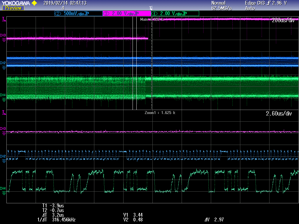

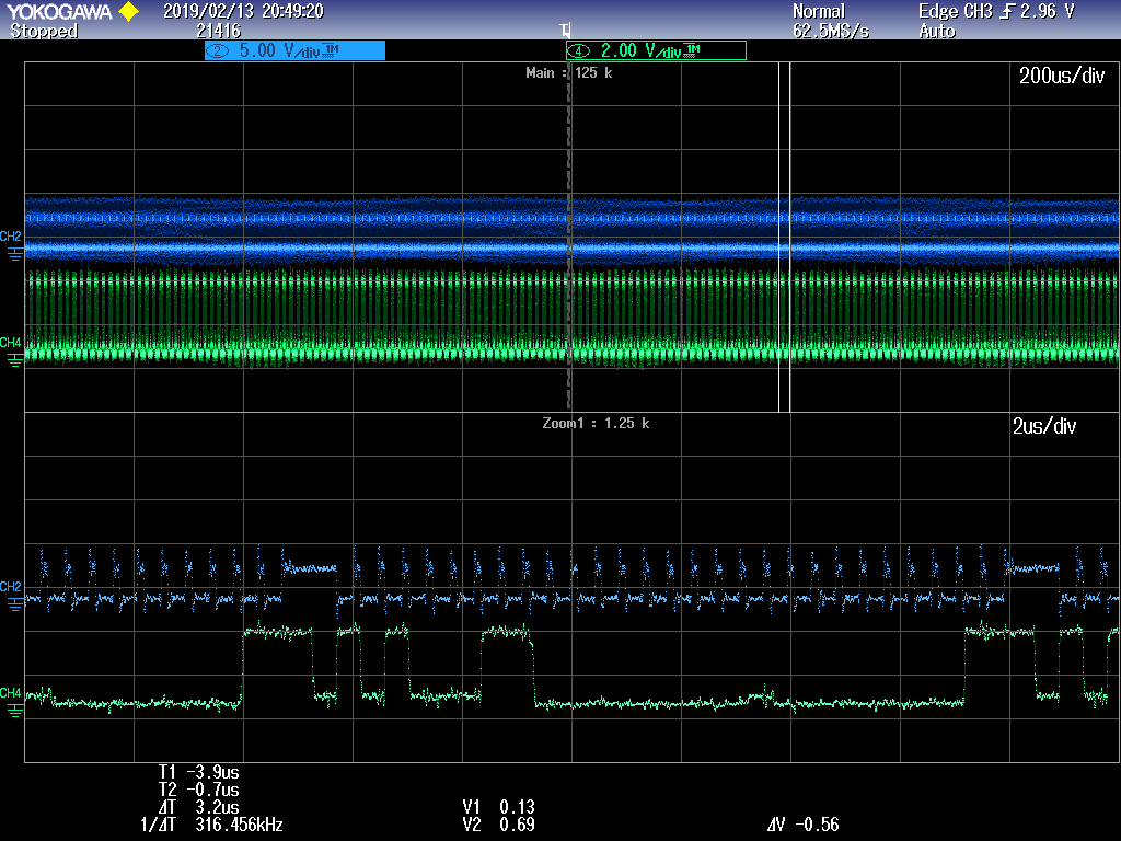

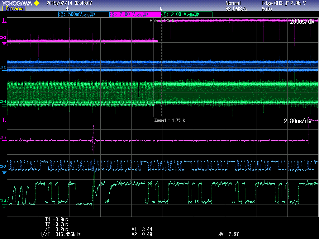

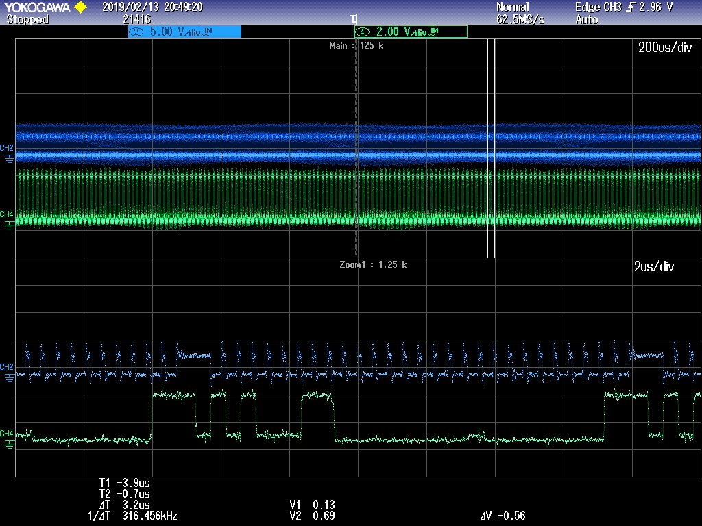

    In the figures below, Ch-2 is the SCL and Ch-4 is the SDA.
    The image below shows the status of the data lines when the communication is happening. The slave address is 51H
    The image below shows the transition from the working mode to the case when the ADC sends NACK. The ADC continues to send NACK even after continuous attempts of Repeated Start.
    The image below shows the case when the ADC sends all bits as zeros.
    The image below shows the case when the ADC sends all bits as ones.

  • Thank you for providing the scope shots. They are rather difficult to read though, as there is a lot of noise, in some cases there are large spikes. I would suggest cleaning this up, the noise could be greatly affecting your I2C communication. You mentioned you are measuring power scheme, you need to make sure that power line noise is not affecting your digital lines. In your layout it is good practice to keep your digital signals far and separate from your analog signals. Also, can you try slowing down your communication, this could help clearly see any timing issues.
    From looking at your scope shots, it might be possible that the timing requirements are not being met. It is not too clear, but seems that SDA and the falling edge of SCL are almost in-sync. It is best to make sure that SDA engulfs the entirety of the SCL pulse. See Data Hold Time timing requirement; I am assuming you are using High speed Mode with Cb = 100pF, this means that you need a minimum of 70nS hold time between falling edge of SCL until SDA should change states.
