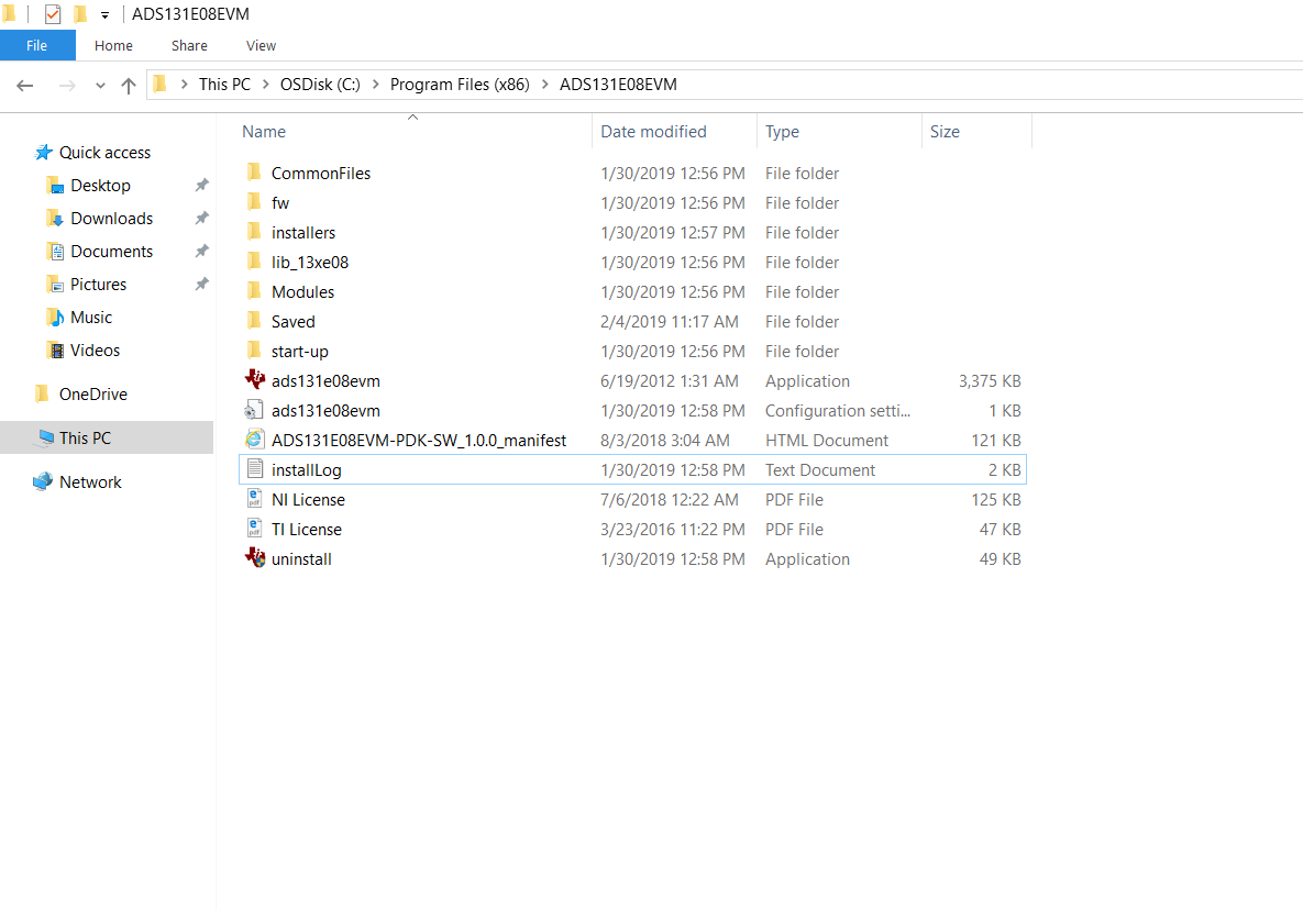

  • Please find attached file which tell from which location I got this file.

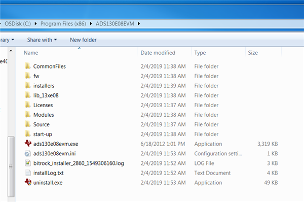

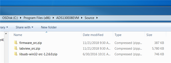

    Apparently, we hadn't packaged in the source files with the ADS131E08EVM software, but it is in the ADS130E08EVM software and the two source files should be the same. You can find the download in the Order Now section:
    www.ti.com/.../ADS130E08EVM-PDK
    If you download the ADS130E08 software, you should see this:
    Inside of the Source directory, you should see this:
    If there are problems, you can look in the install log. There should be something like this in the text:
    Again, download the ADS130E08EVM software, if the download fails to pull up the source files, post the install log.
    Joseph Wu
  • Hi Joseph,
     I downloaded the installer setup from your link. But after installation of that software still I am not able to see source directory.
    Please find attached file for install log and screen capture.
    Yogesh

  • Yogesh,
    This is the same log you showed me before. Additionally, this is the software for the ADS131E08EVM and you want the software for the ADS130E08EVM which has the source packaged. All of the downloaded files in the directory that you're showing is dated to 1/30/19 which is the same as the original files you showed last week.
    I need you to find the download for the ADS130E08EVM. It should be in the same Program Files directory. If source is not there, then post back with the same screen shot and install log.
    Joseph Wu
  • Good morning Joseph,
    Problem Solved !!!!!
    I get "Source " directory after installation. Also there is labview project file....
    Excellent . Great help!!!
