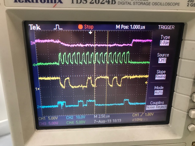

  • hi joseph,
    i am sending 0x421B , THIS 16 BIT VALUE TO ADC,them immediately reading data,
    below is my code
    my FSR is 4.096
    DSPI_B.PUSHR.PUSHR.R = (uint32_t)((uint32_t)(cmd<<16) + data);
    DSPI_B.SR.B.TXRXS = 1;
    response = DSPI_B.POPR.R;
    i am reading data from pop register,
    i am attaching my dso data, first one is cs, clock ,and data in to adc,  and last one data out from adc.
    due to probe prblem it is little bulky,
    and i am not getting any constat data value, continuosly it is changing,
    please tell me after what time i should read data?
    thank you so much for in advance
  • Avanti,
    There are a couple of things that could be going on here.
    Sending 0x421B means that you're using the device in temp sensor mode. This is probably a good mode to look at because you're probably expecting a value near 0x0C80 if the device is near room temperature. You can compare that value with what you're reading.
    Looking at the scope shot, and based on your comments:
    Red = /CS
    Green = SCLK
    Yellow = DIN
    Blue = DOUT
    Now here are the problems that I see with the scope shot. First, there's a lot of noise. It's possible that you're getting some bad values because of that, and noise on SCLK could cause the device to clock out data when the device shouldn't. I would definitely clean that up. Second there are some rounded edges to the clock lines. I'm not sure that's necessarily a problem, but I was expecting to see cleaner square waves. Third, there is something wrong with /CS. The CS line should be from 0V to 5V like the other digital lines. However, it looks like /CS is going ±2V or so above and below the ground based on the oscilloscope. However, it does look like the device is responding at the correct time. DOUT rises at about the time I would have expected when /CS would have started going low. It also rises at the correct time.
    If the yellow line is DIN, then you're not sending 0x421B. To me, that looks like 0x42EB. That would mean that you're reading one of the inputs at a different data rate. I'm unsure because the register DR[2:0]=111 should not be used.
    I would check all your connections. If you have problems with this, send a schematic and maybe a photo of your setup.
    When it comes to reading the data, you shouldn't read the device completely asynchronously. If the device is being used in continuous conversion mode, the device is giving new data at the data rate. You would wait until DOUT/DRDY goes low, and then send the SCLKs to read the data. However, If you wait too long, then the new data could interrupt a read in progress. The DOUT register would be updated mid-read and corrupt the output data.
    If you are programming the device, you need to wait for the device to set the configuration, and then wait for the data period for the conversion to complete. If you set the device to 128SPS, then you would need to wait 1/128 seconds (+10% for oscillator clock variation). That would be about 8.6ms if you set the conversion just as the conversion in progress is about to complete.
    Note that if you are in continuous conversion mode, then this time would be as much as 2x longer. If you program the configuration register, the configuration register isn't set until after the conversion in progress completes. If you set the configuration register just as a new conversion started, then the data from the new configuration won't be ready for two conversion periods.
