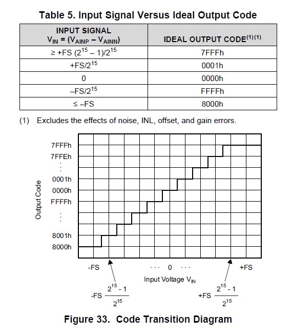

    How to convert the measured voltage according to the conversion result.
configuration:
           1、write: 0x92 0x01,0x84,0x83
           2、write: 0x92 0x00
           3、read: 0x93 xx xx  (xx xx How to convert to voltage value?)
Schematic diagram:
    This devices provides the data in 2's compliment format. This means that all positive voltage inputs will have an MSB of 0, and all negative input voltages will read out with an MSB of 1.
    That means when the input is at 5V, the output will read out 7FFFh, and when the input is -5V, the output will read 8000h. Page 26 of the datasheet goes further into detail about this.
    When converting to voltage, remember that the readings are in hex values in 2's compliment.
    The following blog helps to explain the conversion from code to voltage: How to convert an ADC code to a Voltage

    1、output code:0x00dc
    2、According to the equation:Vin(V) = output code * LSB Size
         myconfig is :010 : FSR = ±2.048 V
         9.3.3 Full-Scale Range (FSR) and LSB Size As shown in.
         LSB Size is 62.5 μV.
         Vin = 0x0002 * 62.5 = 220 * 62.5 = 125   = 0.000125 (V)
         The theoretical value of 0.25mv(Shunt resistance is 0.5 m Ω,The constant current of the load device is 0.5A) is quite different.
    I get a value that's very different than yours, but it is a similar method of calculation:
    Output code = 0x00DC = 220d
    Using the ±2.048V FSR, the output is:
    Vin = 220 * 2.048 / 2^15 = 13.75mV
    (Note that you would get the same value for 220*62.5uV)
    This is significantly different than your expected value of 0.25mV. I would start the debug by trying to measure a different voltage just to check to see if you have a problem in the circuit setup. You could measure a AA battery or a voltage divider from the supply just to see that the ADC is correctly measuring the value.
