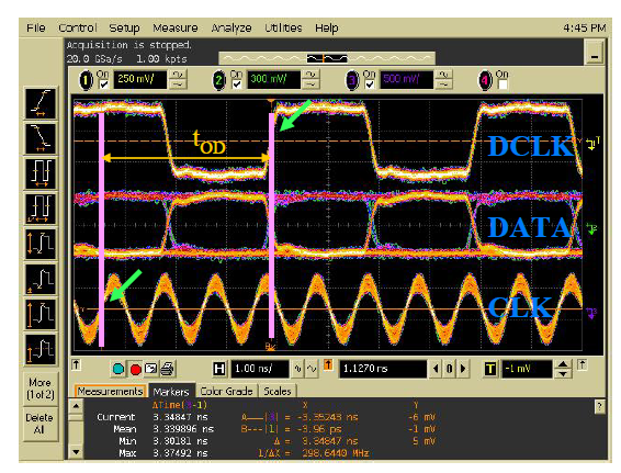

    I'm not sure that that is the timing information that I need. Let me clarify, we are using the ADC clock (DCKI/DCKQ) for the internal logic to the FPGA. Given we are using the output clock from the ADC, we need to know what jitter will be present on the DCLK signals after the ADC divides it down internally. We are using the ADC in non-DES mode w/DDR 0 degree phase, and 1:2 demux. We expect a 400MHz clock to be driven into the FPGA. There has to be some relationship between the input sample clock to the output DCLK signals.
    We need to know the jitter on this clock as it will be used as a reference clock to a PLL inside the FPGA.  The jitter on the input clock (i.e. DCLK jitter) will directly affect the jitter on the output clock (internal to the FPGA).
    The clock to data relationship will be adjusted using a calibration routine to center the clock in the data window. That is a separate topic to this thread.
    John
  • Hi John,
    Thank you for the details. Yes, I understand your question. Unfortunately, there typically isn't much jitter information taken from the DCLK outputs of the ADC in terms of jitter performance. After some checking around and talking to the designers, this information isn't available. I have attached a screen shot of the output to verify that this output clock is very clean and shouldn't have much contribution on the internal PLL inside the FPGA.
    Another way to prove this out is to use an very clean signal generator as the clock source, connect that to the FPGA and benchmark or baseline the FPGA's internal PLL performance. Then use the ADC's DCLK output to see the difference.
