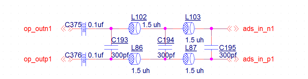

  • We find that, the analog input circuit will affect the err channel.
    we use ad8330 to drive the ads5296, whos output res is 15o om(differential),
    between the ad8330 and the ads5296 is a low pass filter as below
    and my pcb is as below,
    Does the hardware have some problem?
  • i don't see the analog circuit has issue. the mismatch of inductor may affect the filter response, while it should not affect the wrong code, which can be fixed by LVDS timing tuning.

    when you say the analog amplifier affects the noise, what did you do and what effects you have?  you said the output impedance is 150ohm, do you have termination resistors at the ADC side?
    did you try the hardware RESET in the all tests? i saw your sch has RESET pin is floating. maybe you can try a blue wire and see.
    Thanks!
  • I have one board, when the analog amplifier's gain is high( > 30db ), the err bit happens.
    Don't have termination at the adc side, between the amp and the adc, only have the low pass filter.

    high gain means higher signal amplitude. did you measure the highest signal amplitude at ADC inputs? maybe you can add the back to back diodes at the amplifier outputs to limit the ADC input as 2Vpp to 3Vpp. This way, the overload to the ADC is not much.
