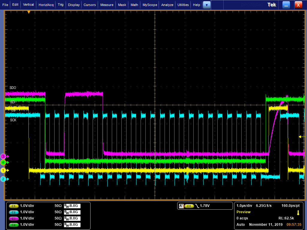

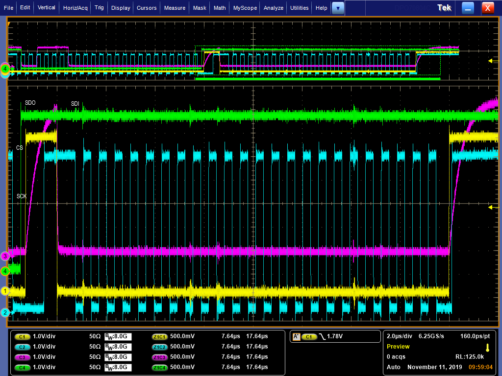

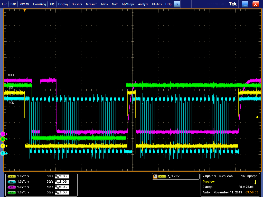

the FPGA SPI code should matter, bu I can't locate it, here is the full waveform of reading reg0:
and the zoom in of waveform above:

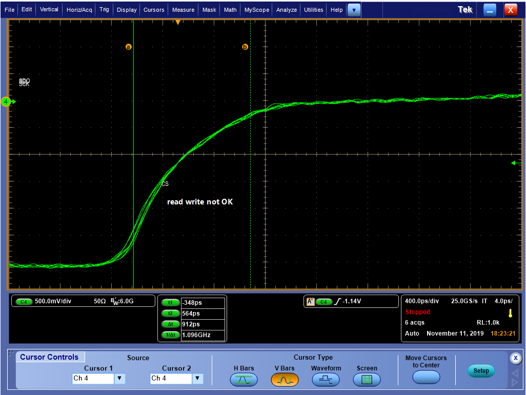

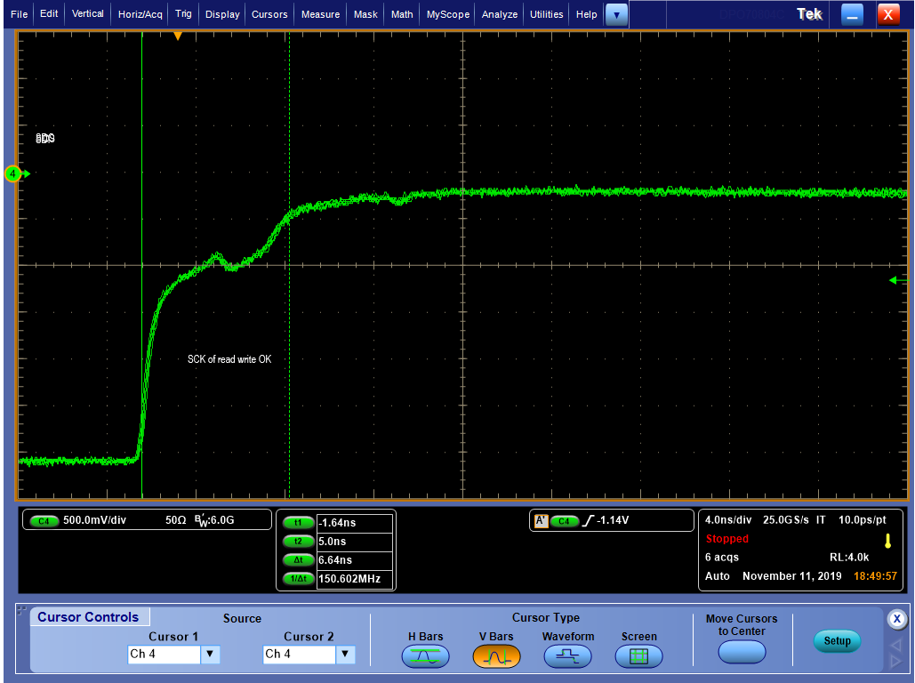

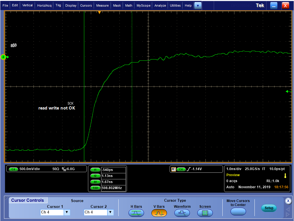

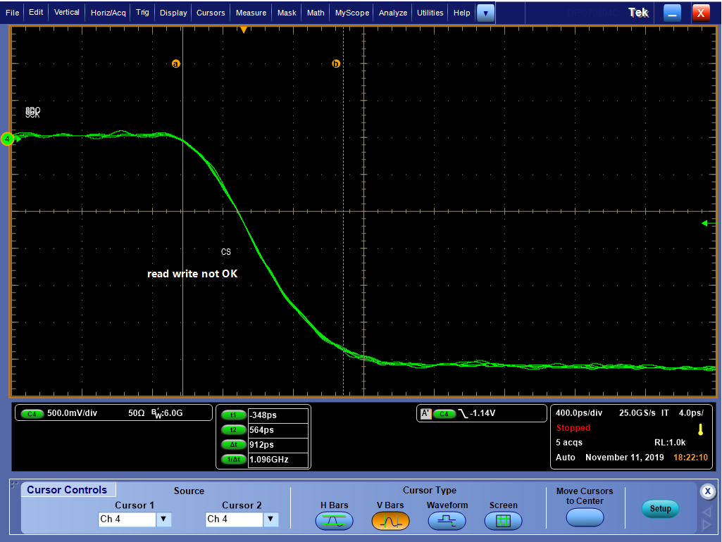

  • I've captured the SCK and CS rising/falling edge waveforms below, all signals are tested very near to the chip's pin, the test probe is 6GHz bandwidth.
    I don't think the signals are poor quality.

  • two experiments I added to debug it:
    1, add a 22pF capacitor between SCK and GND near the chip's IC, and the failed access becomes OK, then I remove the capacitor, it fails agian. I don't record the waveform.

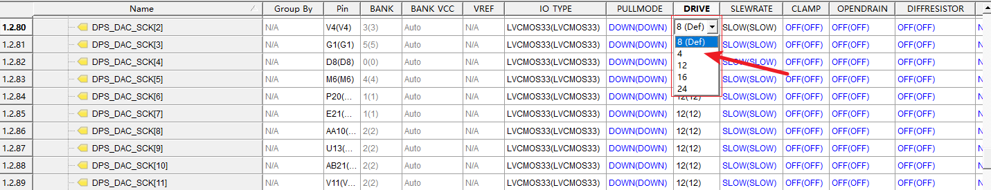

    2, there's no reserved capacitor on my PCB board, so I try another similarly method, change the drive strength of the SCK in FPGA

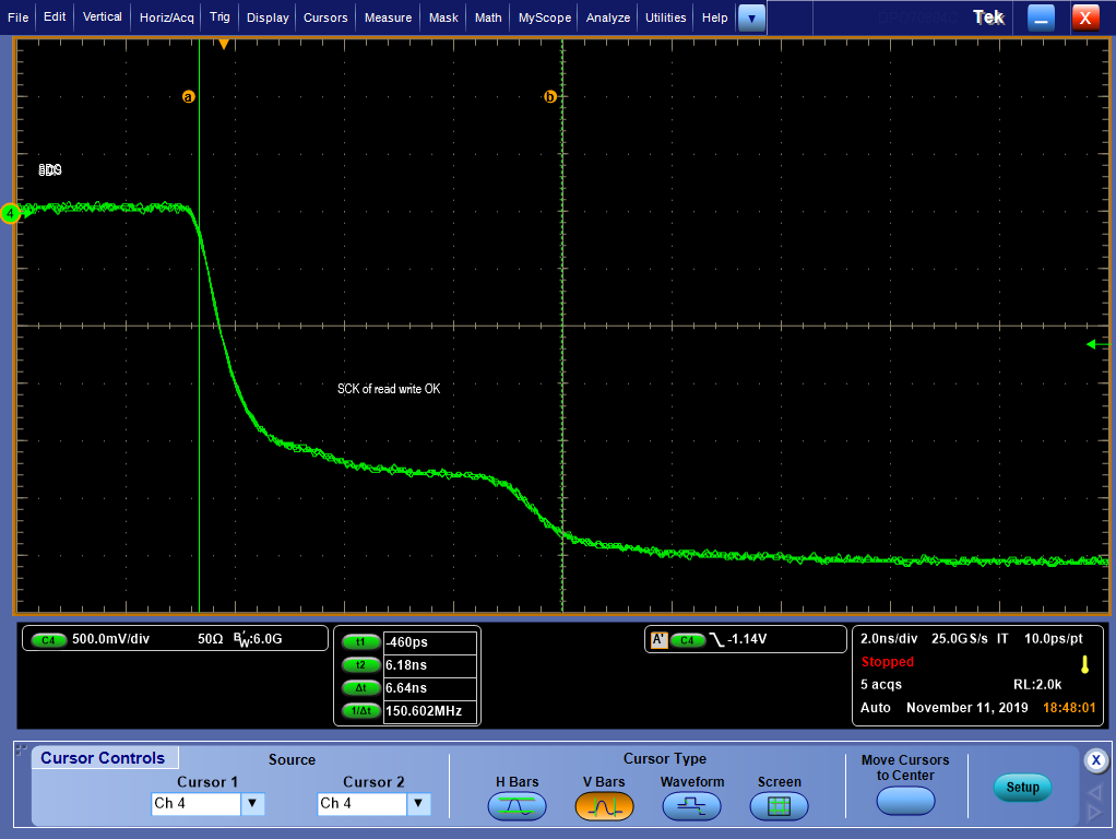

    I have tried 4mA/8mA(default)/12mA, and only the 4mA are all good in my 5 test DAC8734 chips, in 8mA, the third chip access failed and the 12mA, the first failed. I've the SCK waveforms of 4mA:
    a poor signal quality leads to a successful access, so I feel so puzzled and helpless

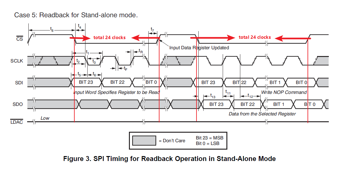

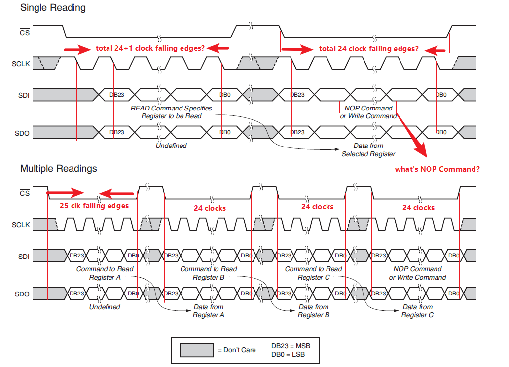

  • I find some contents on page 24 of  the datasheet confuse me:
    and the timing diagram of stand alone mode on page 11:
    1: which one is right?
    2: what's NOP Command?

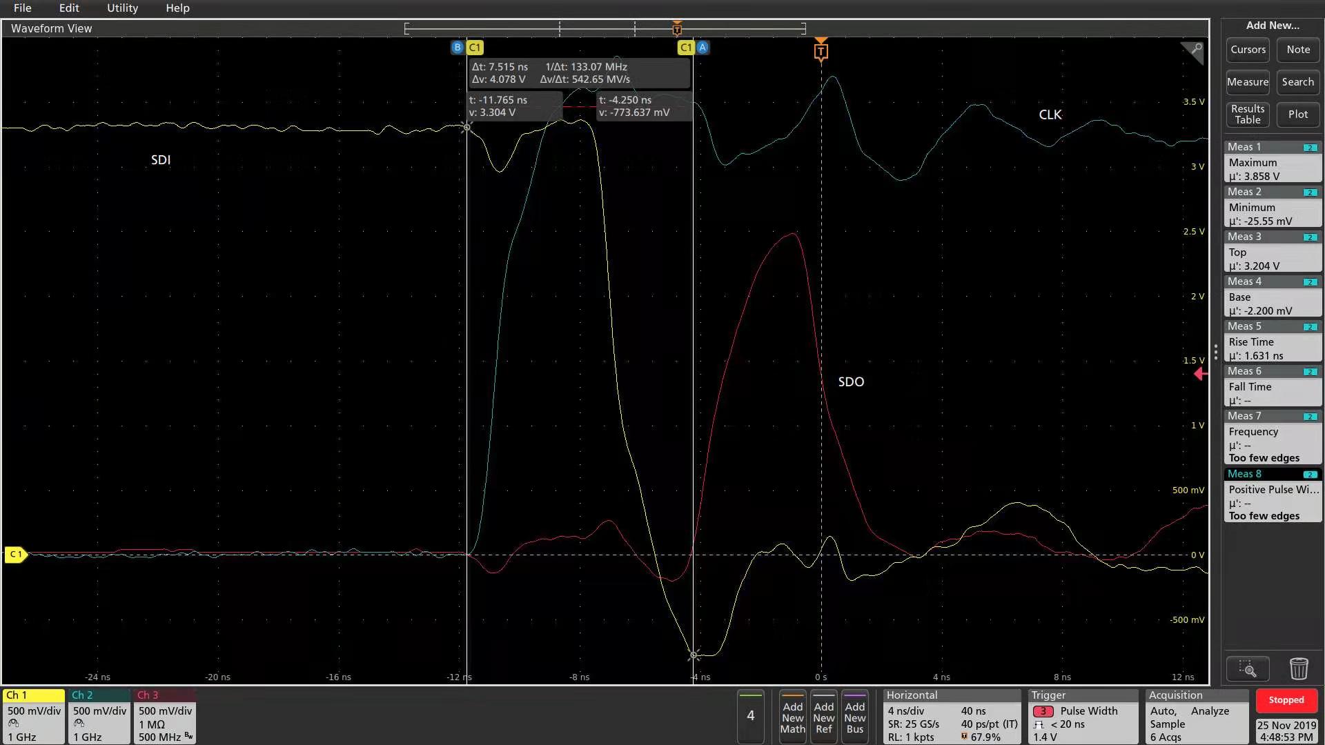

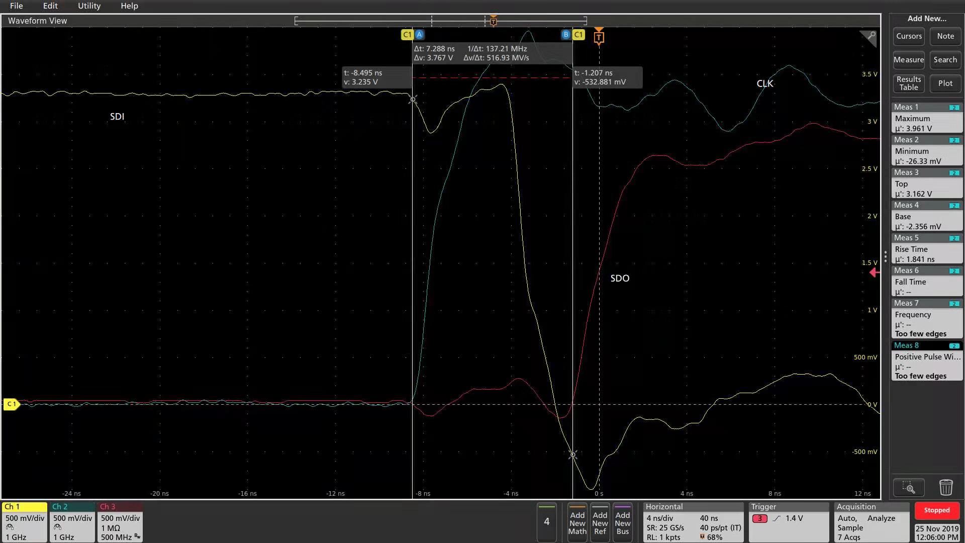

  • here is another waveform group:
    The data I send to two DAC8743 is 0x8000AF,
    but  SDO returns are not the same, first is 0x00024F which is wrong and the second is 0x80003C which is right.
    the wrong IC and the right IC share the same power supplies on the PCB
  • I think the chip has a severe bug, if an SDI falling edge and a clock rising edge appear at the same time, an unexpected clock glitch may occur inside the chip.
