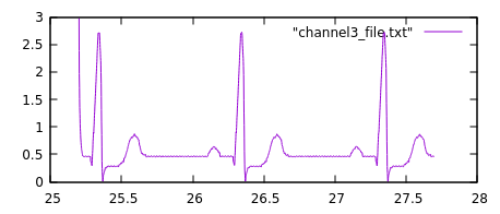

Now, my query is I am not getting below channel graphs as expected compared to your reference board. I am using CARDIOSIM II simulator and my registers are configured as per done in reference board.
Channel_1 : V6 - Channel1.png
Channel_4:  V2 - Channel4.png
Channel_6:  V4 - Channel6.png
I am attaching .img files for the respective channels, I am not getting why square waves are generating in my graphs. Rest all other channel's data are as per expected as you can see in the image files.

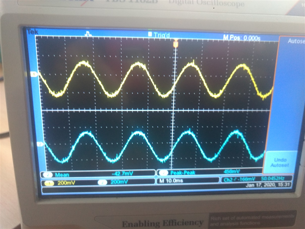

  • Hello sir,
    I checked for is there any clipping in the inputs on Oscilloscope I didn't see any clipping there, i am attaching images for reference. I also verified code to voltage conversion is correct.
    In the image file yellow line representing for correct channel results and blue line is channel with not giving correct data,
    V2: ch4_v2.jpg
    V4: ch6_v4.jpg
    V6: ch1_v6.jpg
       We are taking inputs for plotting, as after jumper points on hardware and same showing on Oscilloscope.
    is there any another possibility for such channel outputs? (i mentioned in earlier post)
    Thanks and Regards.

  • Hi Koustubh,
    How is it that you have a negative reference voltage? (VREFP - VREFN) = -0.21V?
    Was this measured with respect to ground or AVSS?
    Are you using internal or external reference? Can you post a schematic?
    If all of the register settings are the same compared to the reference board, and the reference board is working properly, more than likely there is something on your new board that is causing these errors. I would check the power, reference, and grounds of the board. The waveforms you have showed me seem to have quite a bit of noise on them which could be caused by an external source on the board. This may disrupt or shift the ground level of the board which would lead to issues.
