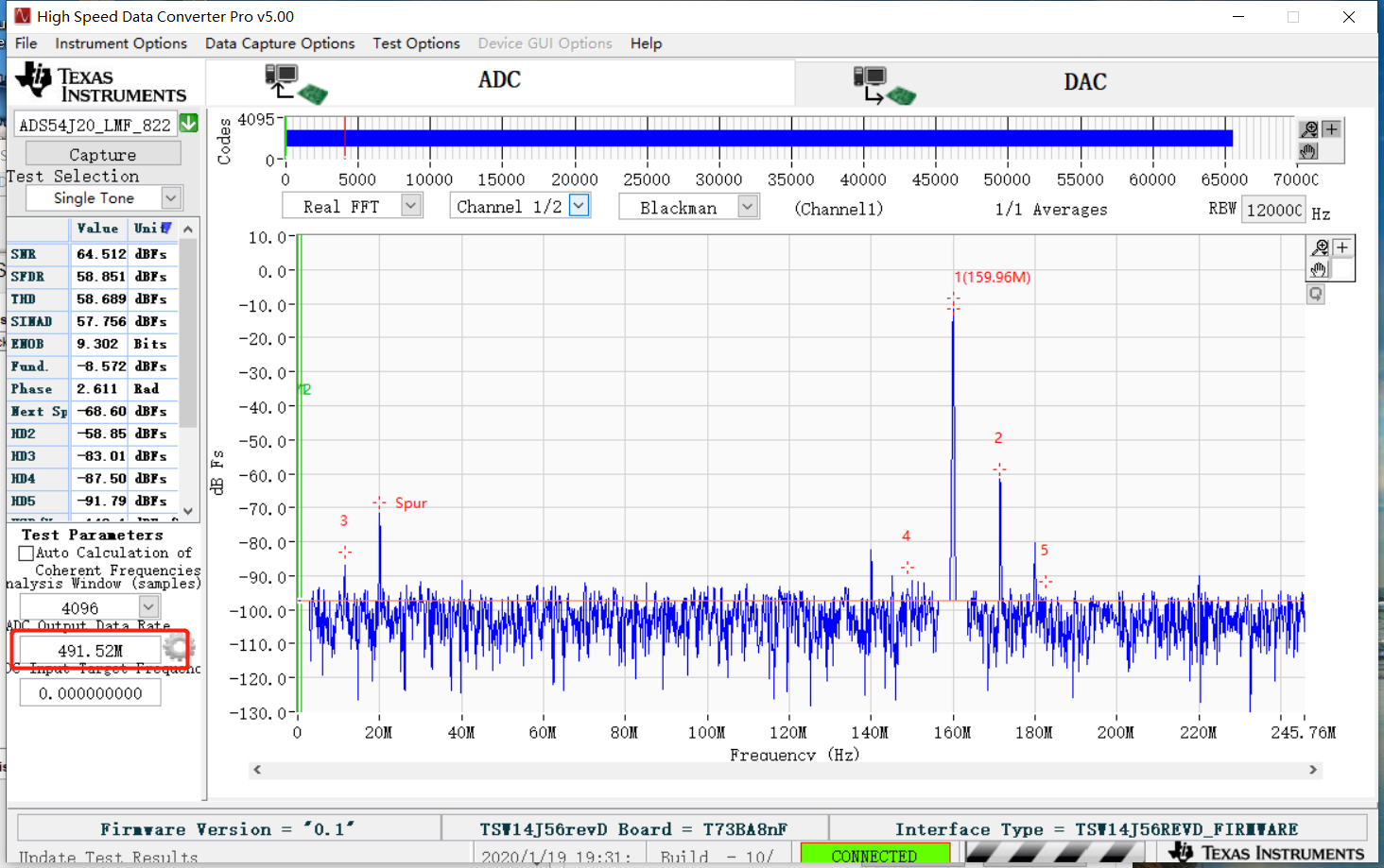

    [update] when I switched from the signal generator to the external CLK and downloaded the configuration name for lmk_config_external_clock.cfg, LED2 did not light up, indicating that PLL2 locking had failed.So I can't find a solution, so how do I work in external ref clk mode?
    In the onboard VCXO mode, the input signal is 160MHz. I download lmk_config_onboard_983p04_msps.cfg, and then open HSDC sampling when the ADC output data rate is set to be greater than 491.52M,the sampled fundamental is greather than 160MHz ,and the D4 is put off,D3 is keeps on,why it is hanppen?

    To operate in externa; clock mode, apply a clock source with about 10dB of amplitude to SMA J6.  Load LMK_config_ext_clk.cfg, then press the rest button, then load the desired ADC config file. Since the PLL of the LMK is not used in this mode, LED2 will not turn on.
    If the data rate you enter in HSDC Pro does not match the actual data rate, the software calculations will be incorrect  and will display the results in the wrong location because of this. It appears you have the wrong clock setting used for the screen shots you show above. Always press the board reset button after loading a new LMK config file but before loading the ADC config file.

  • Suy,
    Per the data sheet, the minimum sample rate for this ADC is 250MHz. You are trying to use 122.88MHz, which is to slow. This is why you are getting this error message.
