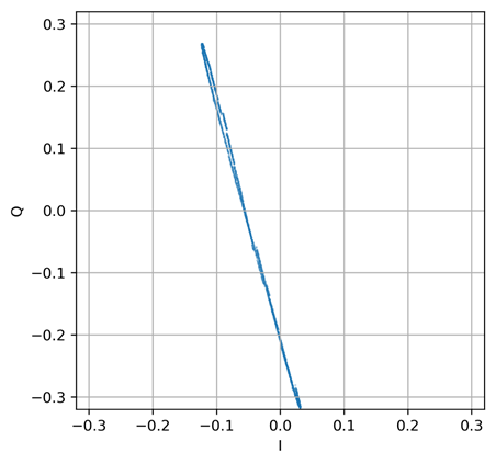

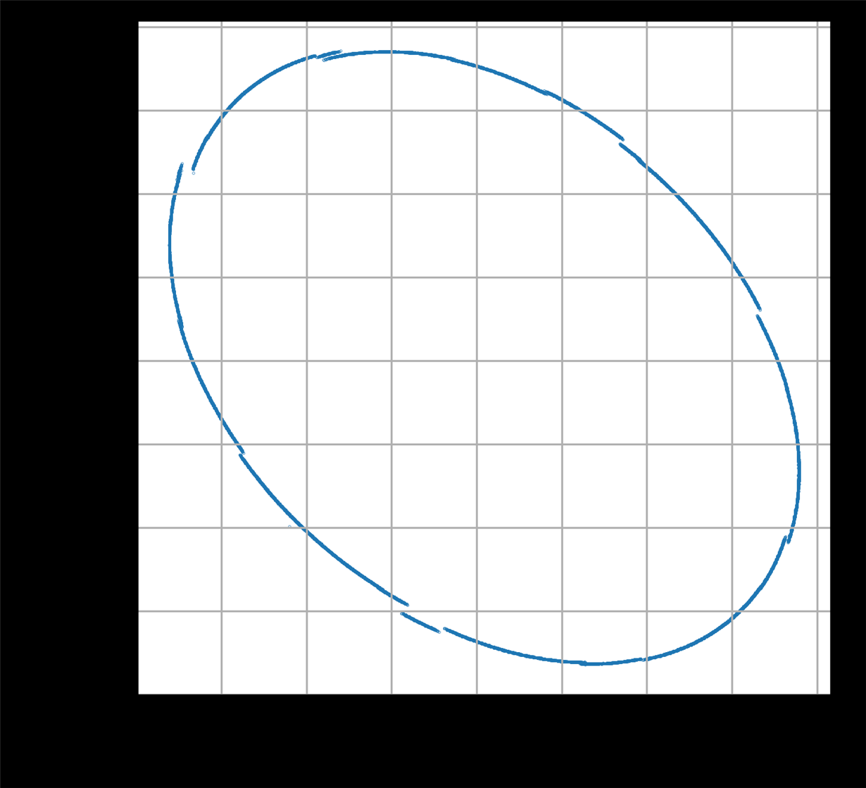

We are using a ADS9224R dual ADC in a zero-IF receive channel for RFID. We plan to have 25 of these receive channels interfacing to an FPGA. The ADC is intended to sample at its maximum sampling rate of 3Ms/s and we don’t want to use parallellisation of the serial data output data to be able to connect all channels to the FPGA. So we are running the serial data output at 60 MHz with a bus-width of one. We are using zone 2 datatransfer and retiming for the SPI interface (the STROBE is used as clock for the SPI data towards the FPGA)
With a 231kHz signal in the receive channel the IQ output from the ADC’s looks like the next plot:
In the plot we see discontinuities we don’t expect. These discontinuities disappear if we reduce the sampling rate to 1.5Ms/s and leave the serial data-rate at 60MHz as can be seen in the next plot:

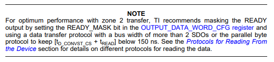

In the datasheet page 29 I found the following note:
This note, which we didn’t notice during the initial design, seems to suggest one needs to use at least 2 SDO’s in parallel and keep the data-transfer within 150ns, “for optimum performance”
This note might explain the problems we see, but it is not completely clear and leaves some questions unanswered.

  • What is meant with “For optimum performance with zone 2 transfer ….” In the note on page 29 of the datasheet?
  • Why should T_D_CONVST_CS + t_read be below 150ns as is indicated by the note ? Our measurements with 1Ms/s, SPI 20MHz show a good performance, while exceeding the 150ns ?

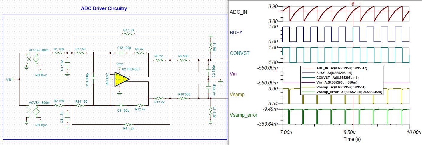

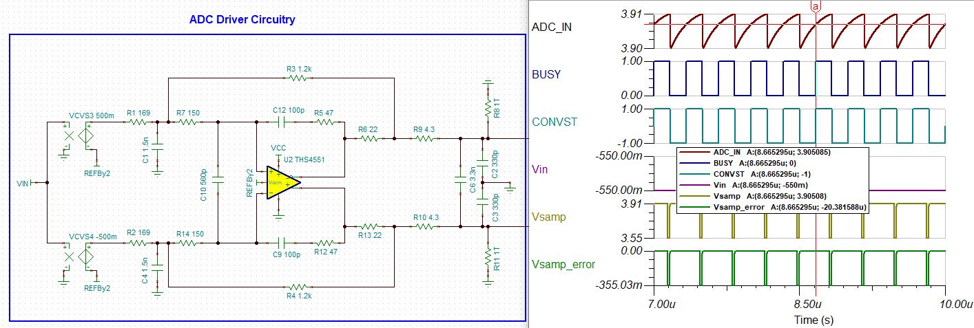

  • Hi Bert,
    Please find the simulation results below. The important conclusion to observe is the difference in settling voltage error. This was measured by taking the difference between the DC steady-state voltage at the ADC input and the voltage across the sampling capacitors at the end of the acquisition phase (approx. 173 ns). Both circuits were tested with a DC input of -550 mV, which produced +3.905 V at the ADC input following the FDA stage. This equates to about -0.5 dBFS as near full-scale produces the worst-case settling. Your original circuit had a settling error of about -9.58 mV (about 77 LSBs). The EVM circuit had a settling error of about -20.382 uV (less than 1/2 LSB).
    You can use the attached TINA-TI simulation file to see the difference. Clicking the "DC" button with the green circle will display the DC steady-state voltages at each meter. Use the value observed at "ADC_IN" to adjust the "Vin_ss" voltage source as needed before running Analysis -> Transient with different "VIN" voltages.

  • Hi Ryan,
    With the input you gave and the help of the simulation file you provided, we were able to modify the driver circuitry such that the settling error is close to what is achieved on the TI application board.
    The discontinuities we saw are completely gone now.
