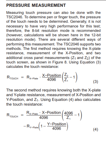

1. to measure the pressure we need to know X-PLATE resistance, or both X and Y plate resistance.
But where can we find this parameter, is it hardware determined?

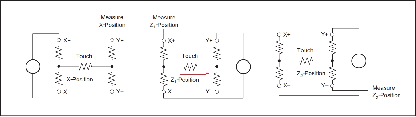

2. For datasheet Figure 8, there is a resistor naming Touch, what does it mean?
And my customer sometimes will read Z1 larger than Z2, which will result in negative Rtouch, what may cause the phenomenon?

    The "Touch" resistor is supposed to represent where your finger is pressing on the touch screen.  The four-resistor diagram is a large simplification of the touchscreen itself and the 5th resistor was supposed to help visualize where the connections were being made on the touchscreen for the pressure measurement.

    Thank you for confirming the connections.  Can you confirm which of the two methods shown below in the datasheet information that they're using for the pressure measurement?  Looks like it's the 1st option.
    One thing to note is that the Z1 measurement looks to only return 81.  Do they ever get different values?
    The "Plate Resistances" will be the total touchscreen resistance values which should be provided in the resistive touchscreen datasheet.
