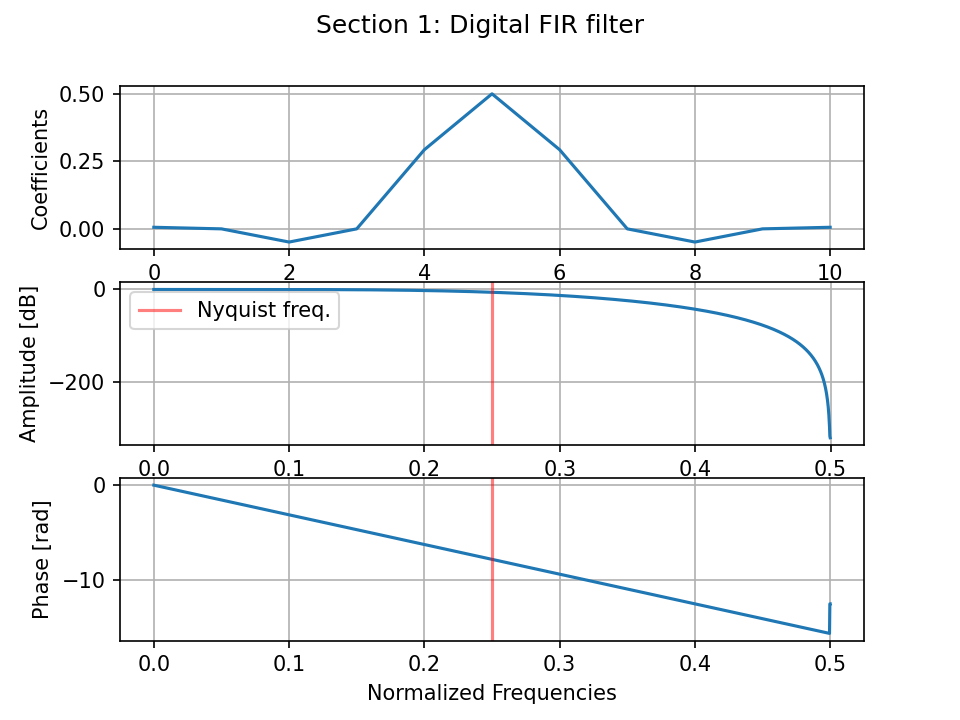

I also noticed about the coefficients that all sections except last one does not filter all frequencies below Nyquist frequency. It seems to me a big twist on Nyquist theorem. So my second question is almost the same: is there any good reason to design your filters such a way?
I included below the fft plot of section 1 (decimation factor 2, so should filter below 0.25)

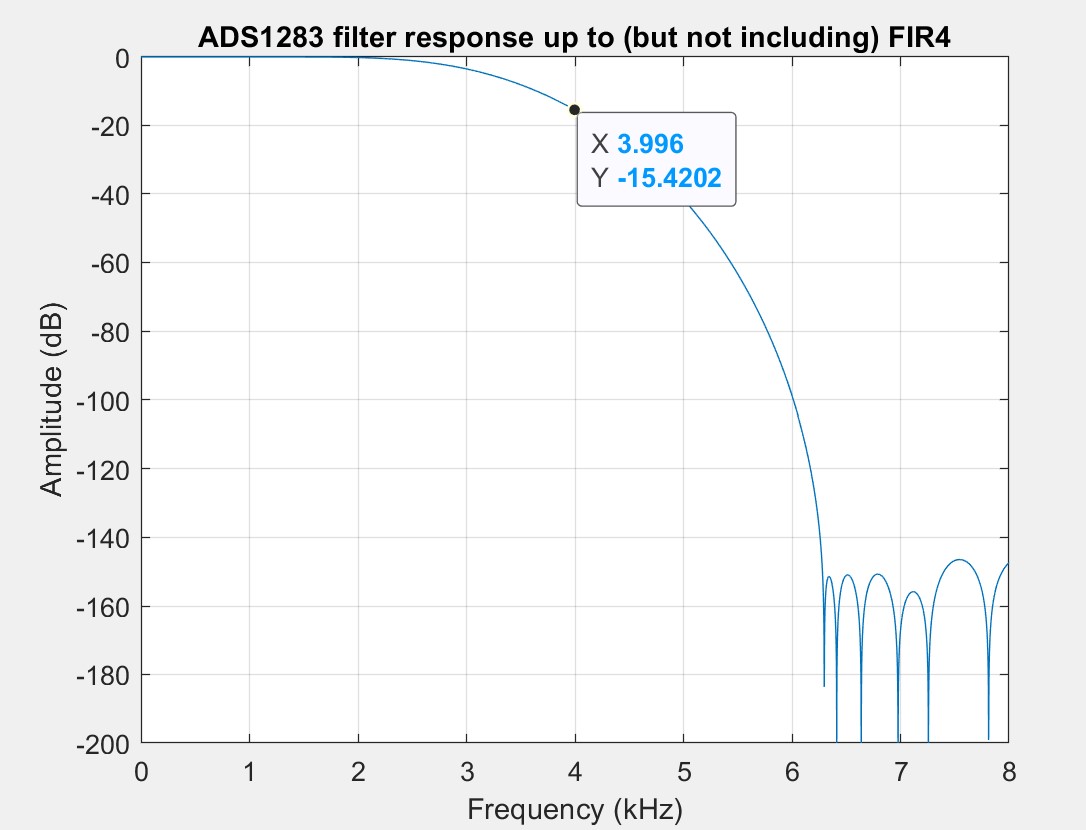

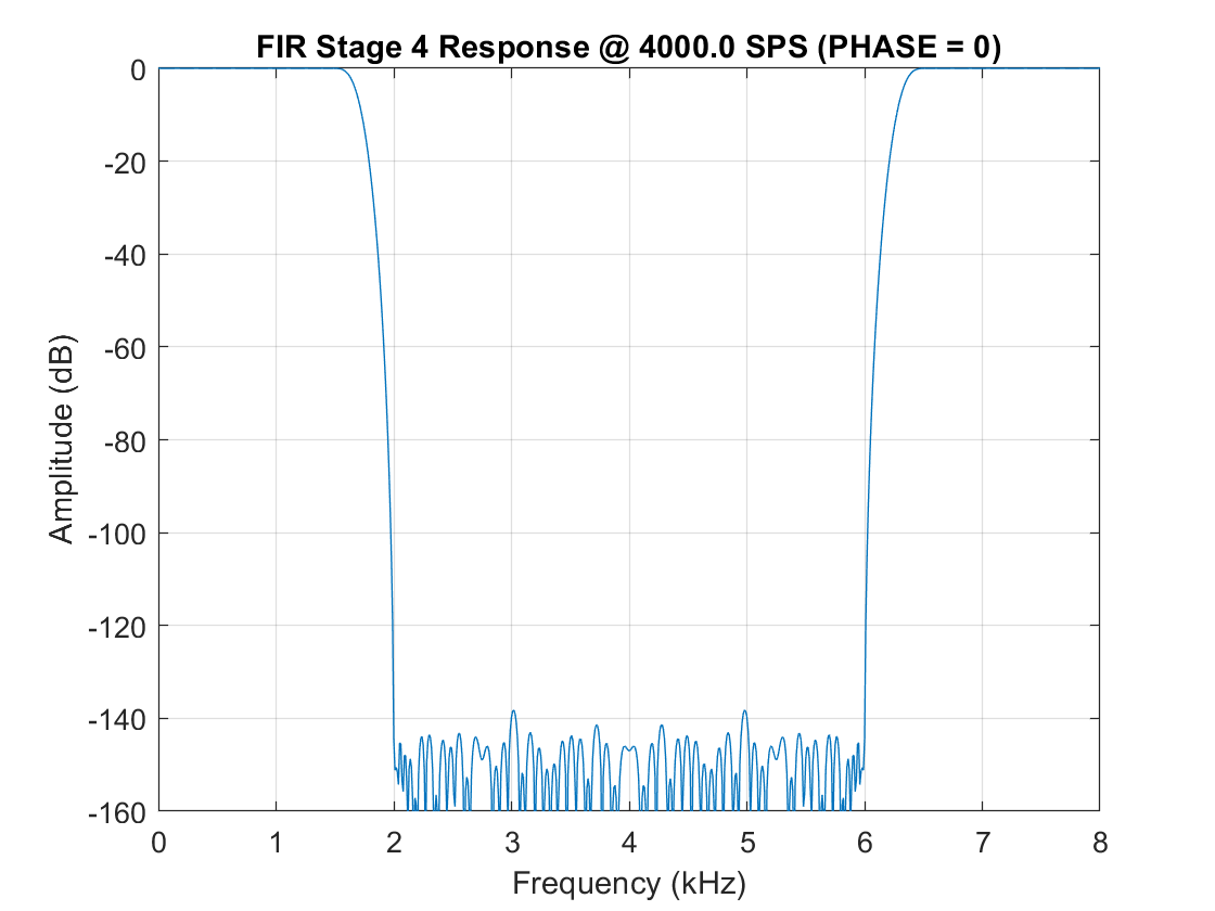

    • Regarding the last filter section, expect for a small passband ripple I'm not exactly sure what you mean when you say that that this filter does not filter all frequencies below Nyquist...When I plot the amplitude response of the fourth filter stage, this is what I get:

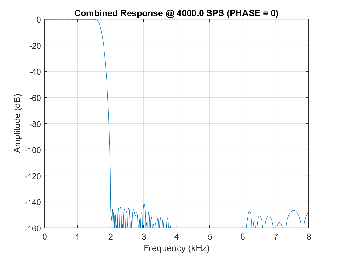

      This is the response of just the 4th FIR filter stage for the 4kSPS data rate. The cuttoff frequency is around 1.65kHz. Keep in mind that the ADS1283 FIR filter is a multi-rate filter where each section decimates the input data rate into the next filter stage. Therefore, the passband repeats at integer multiples of the input data rate (8 kHz for the last filter stage). However, when you combine the responses of all filter stages, the overall response will not include the reflected passband of the 4th stage FIR filter, as shown below:

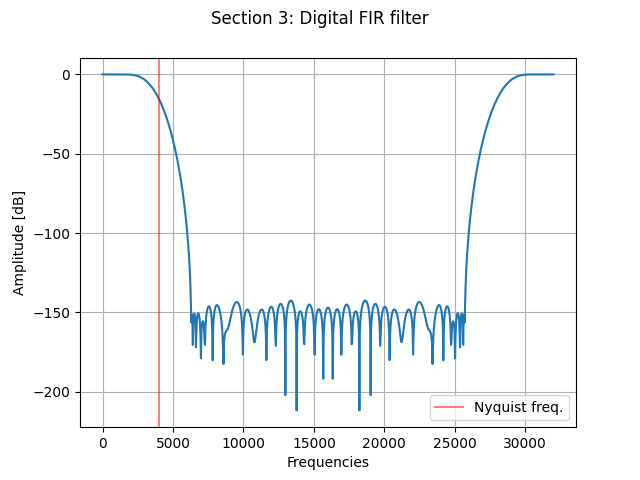

    For an overall output sps at 4kHz, let's take the 3rd FIR section.
    Its input data rate is at 32kHz (comes after sinc filter at decimation 8, and 2 FIR filter sections at decimation factor 2 each). Its decimation factor is 4. Therefore, it must filter any frequency below 32 kHz/8 = 4 kHz, to be allowed to decimate at 8 kHz.
    But it filters properly only for frequencies below ~6.3 kHz (see image attached). This concern also applies to 1st and 2nd FIR section.

    I'm not sure I follow along with the reason why the third FIR filter stage would need to have such a large attenuation at 4kHz. If you have any resources that you could point me towards to learn more I would welcome that!
    However as I understand it, the third FIR filter stage is receiving sampled data at 32kSPS and outputting data at 8kSPS. The third filter stage has a bandwidth of 16kSPS, where as the 4th filter stage only has a bandwidth of 4kSPS. The third filter stage is already proving some noise attenuation around 4kHz (though it is only -15 dB); but then in the fourth filter stage 4kHz will be attenuated much more significantly.
    Therefore, I don't think there is any concern regarding noise aliasing since the Nyquist frequency is getting attenuated more and more with each additional filter stage.

    OK, regarding your comments, I just understood something:
    Does the global decimation process (ie. picking one sample out of 32) come after the global filtering process (ie applying all filter stages)?
    In that case, it makes sense and you're right the 4th filter stage will attenuate every remaining aliasing noise due to lower attenuation of previous stages. I thought an intermediate decimation was done after each stage...

  • Hi Max,
    Each filter stage should be applying a decimation before data is provided to the next stage, which means you can model each successive filter stage as having a decreasing sampling rate that is decreased by the decimation ratio of the previous stage. So it is not a global decimation, but each filter stage is utilizing all of the filter taps before data is decimated.
