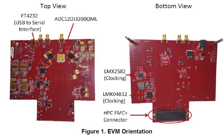

I am designing a fixture using this part and would like to know physical dimensions (for location of FMC connector, height and location of standoffs, etc.) Are there mechanical drawings or a 3D model available for this part?

The attached step file helped with locating the FMC connector! However, the 3d model doesn't seem to include the standoffs near the two corners. These are, however, shown on the ADC12DJ3200EVMCVAL Evaluation Module User's Guide and thus I want to know its dimensions. Let me know if these are connected and if the step model you shared just didn't include them for some reason. Thank you.

Thanks for the standoff file. I still don't see where the standoffs would be connected to the simulator as I need to know the location especially relative to the FMC connector.

Please see the attached .brd file. You can use this find the location of standoff on the PCB.
