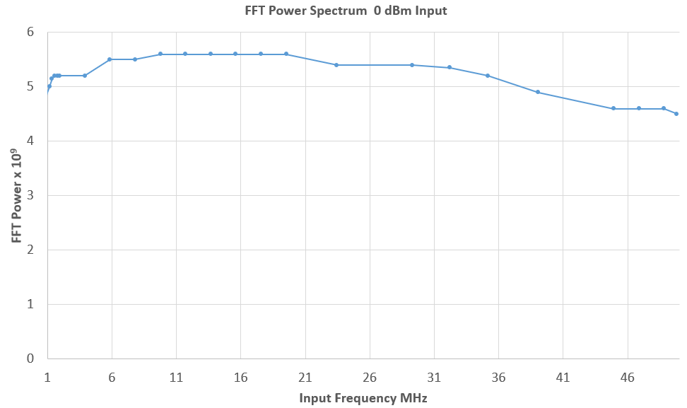

I am using ADS42LB49 at 100 MHz sampling rate and an FPGA to perform FFT.
The power spectrum does not look uniform when sweeping a signal from 0 to Fs/2 on the input.
It is lower on the low end and the high end of the spectrum as in the attached drawing.
Is this related to the ADC specs? I know if the clock jitter is high it can effect the high frequencies but not sure why the low frequencies are lower as well.
