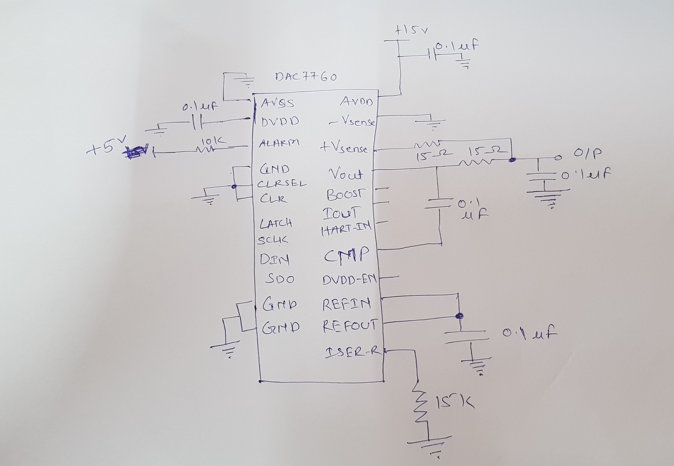

Hi Rameez,
There could be many causes of this. Please share your schematic as a good start.

In the above circuit i have boost pin open. When i power the DAC the boost pin output gives 15V. Is there any issue with it.
Hi Rameez,
Boost should be equal to AVDD if there is no current on IOUT.

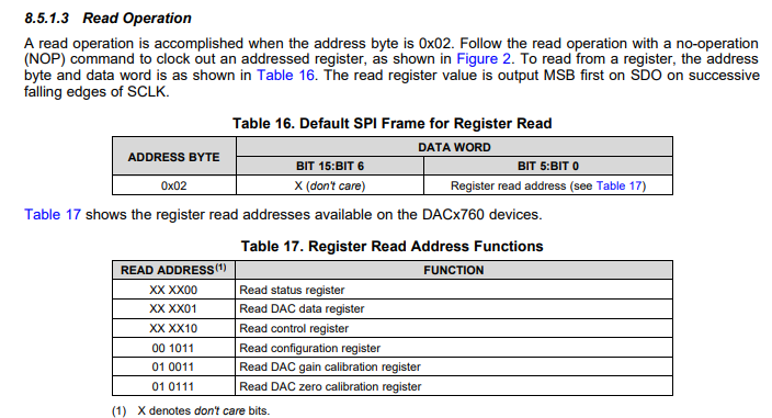

So now help me in writing and reading the registers for DAC 7760 as it 12 bit.
You are telling that out of 16 bits only 12 bits are latched and most significant 4 bits are ignored.
But in datasheet below table 18 it says least significant 4 bits are ignored.
So how to configure the registers for 12 bits and which bits should be ignored.
Hi Rameez,
You are correct, I miss read the table. Bits D3:0 would be ignored.

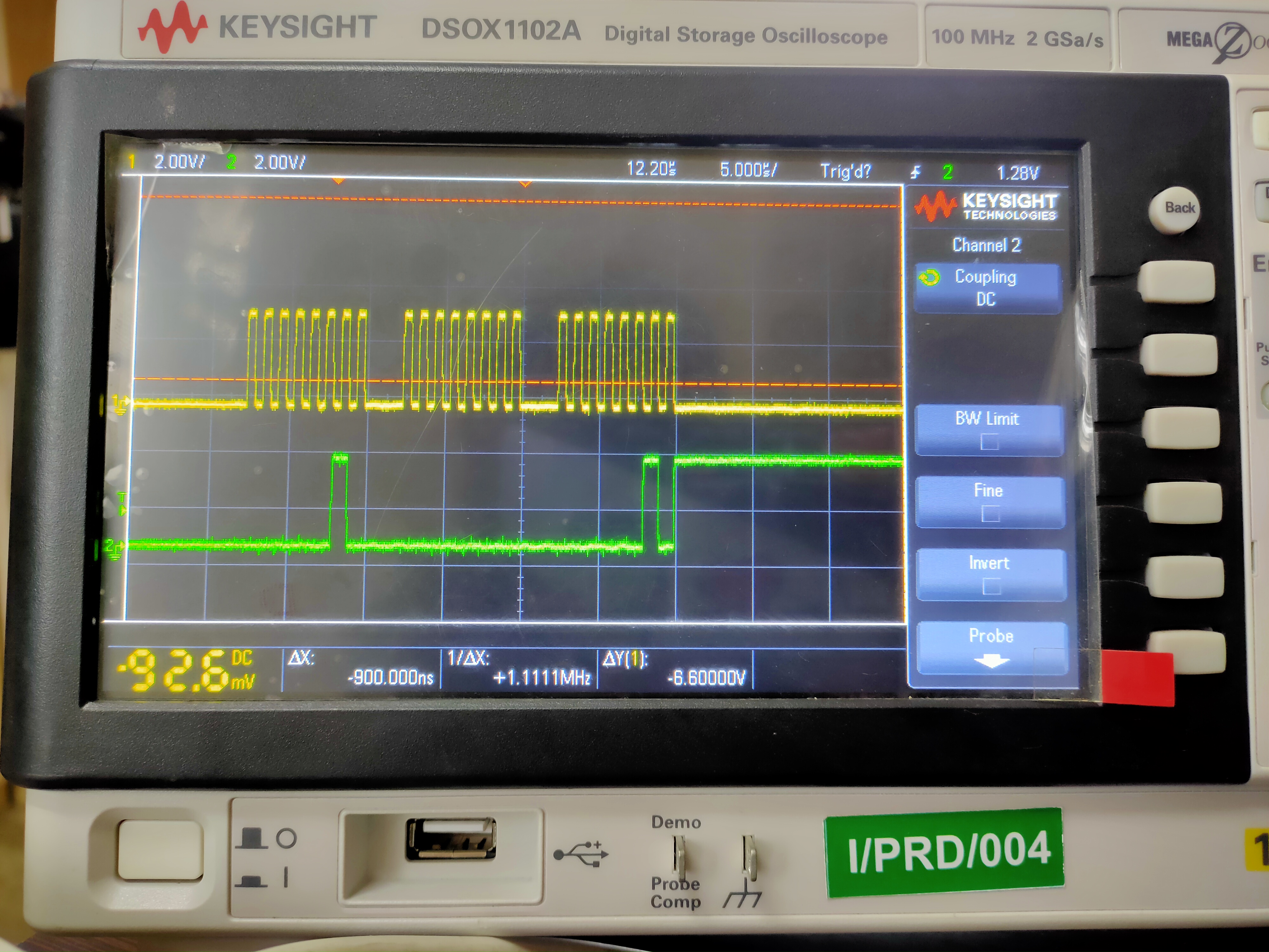

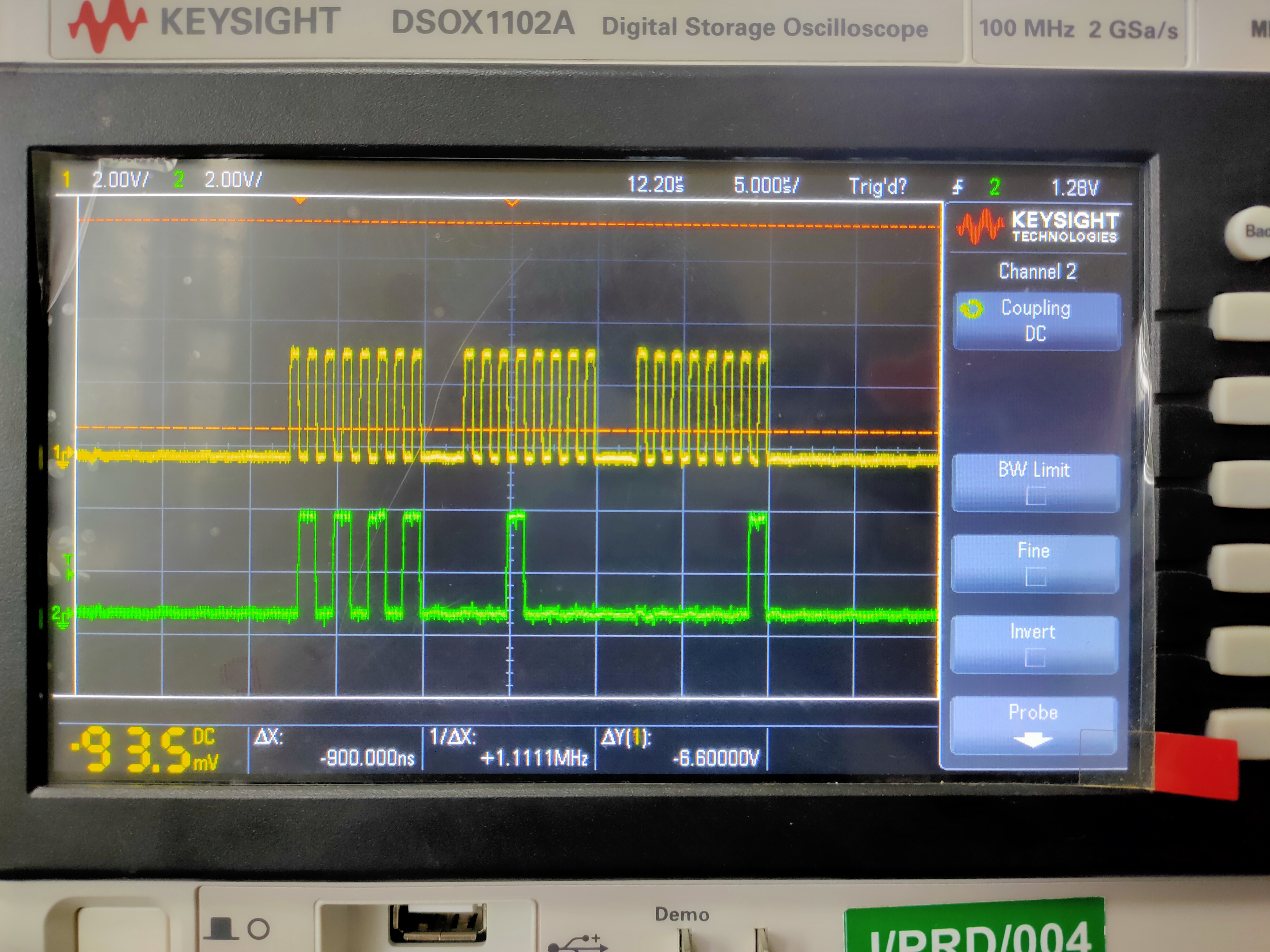

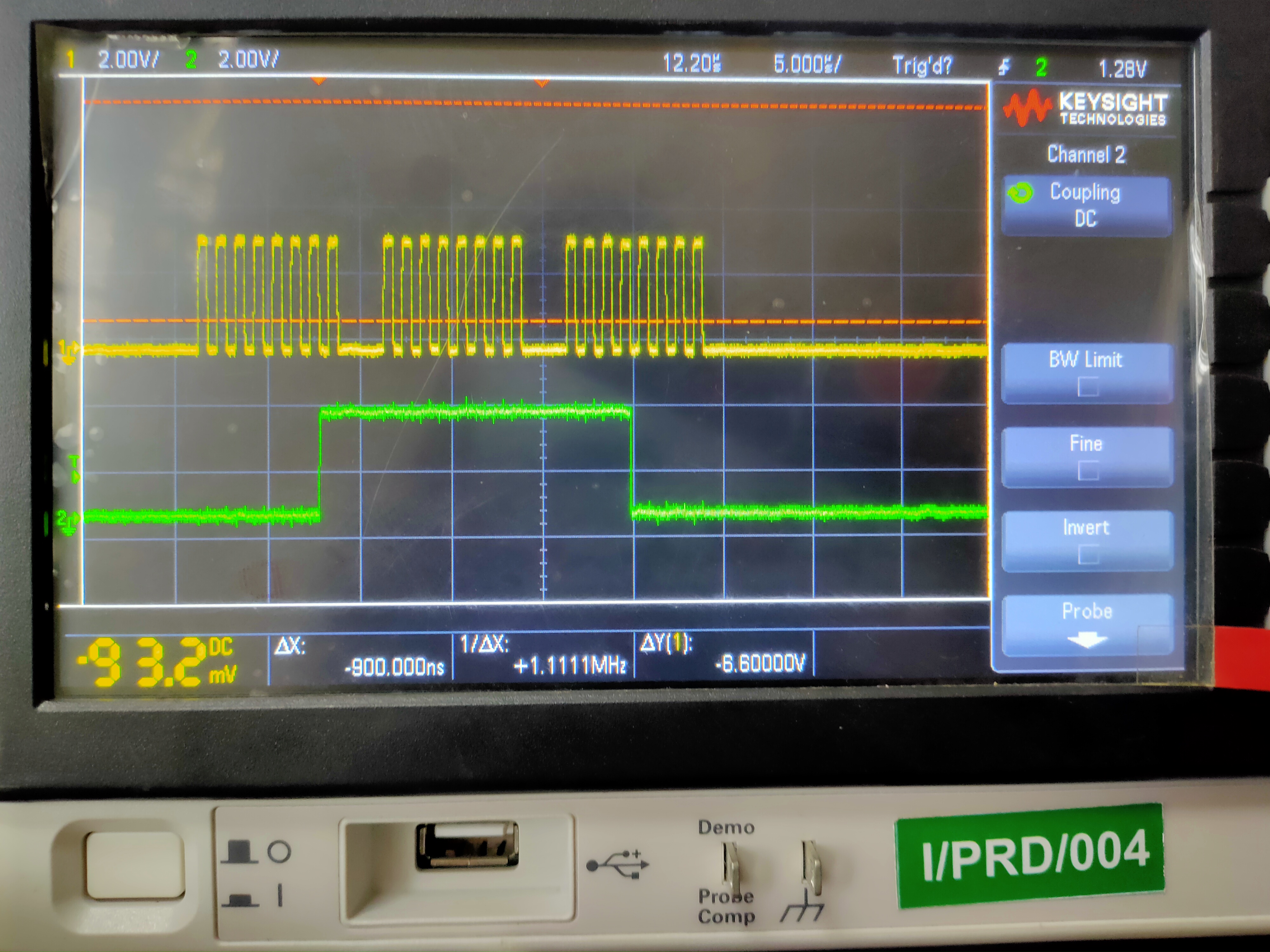

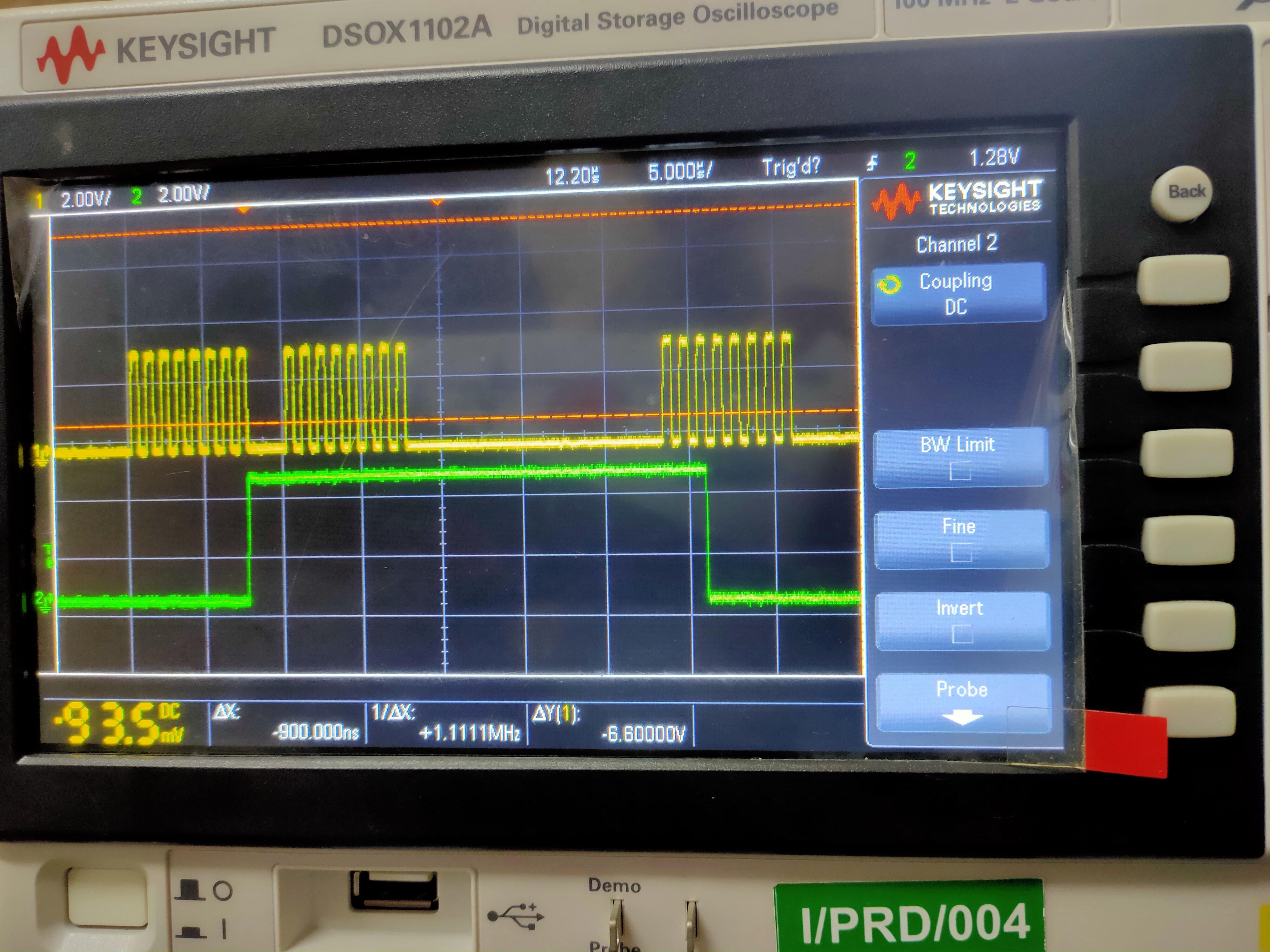

I have few questions:
Are control & configure registers R/W or only W?
I'm able to write to these registers but can't read them.
Only DAC Data Reg can be read.
What should be the exact problem for this.
I have attached waveform for SCLK & SDI/SDO,
1st is Reading Control Register.
2nd is Writing Control Register.
3rd is Writing DAC Data Reg.
4th is Reading DAC Data Reg.
Hi Rameez,
The configuration register is readable, but the data is clocked out in the next command.
So if you want to read the configuration register, you issue the following commands:
1. 0x020002 //this set the config register as the next read
2. 0x000000 // this is the NOP command that must immediately follow. I do not recommend using the next write command in your case.
