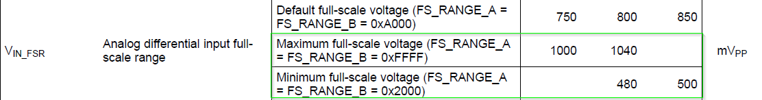

Hi, Staff
There is a register that sets the full-scale value of FS_RANGE_A and FS_RANGE_B.
(Datasheet SLVSEH9A Table59, and Table60)
When the set value is 0xA000h (40960d), it is FS=800mVpp full scale.
For example, if you set the value to 0xA1000h, what is the full scale Voltage? (810mVpp?)
In other words,
When increasing the value by 100d, does the full scale value increase linearly?
What is the amount of full scale to increase?
If not increasing linearly, how much linearity is guaranteed?
