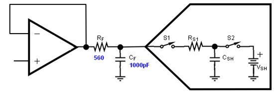

HEllo ,
Thank you Tom Hendrick, for replying to my previous post .... in which you had specified the use of ADS7828 EVM that could be interfaced to the Beagleboard xm.
Now i would like to know what kind of an input circuit should be designed for ADS7828.... ( mostly using a buffer OPAMP)...to which any ac/dc input could be provided.
Thanking you,

Hi!
This is the basic circuit:
For the amplifier, you might look into the OPA171.
