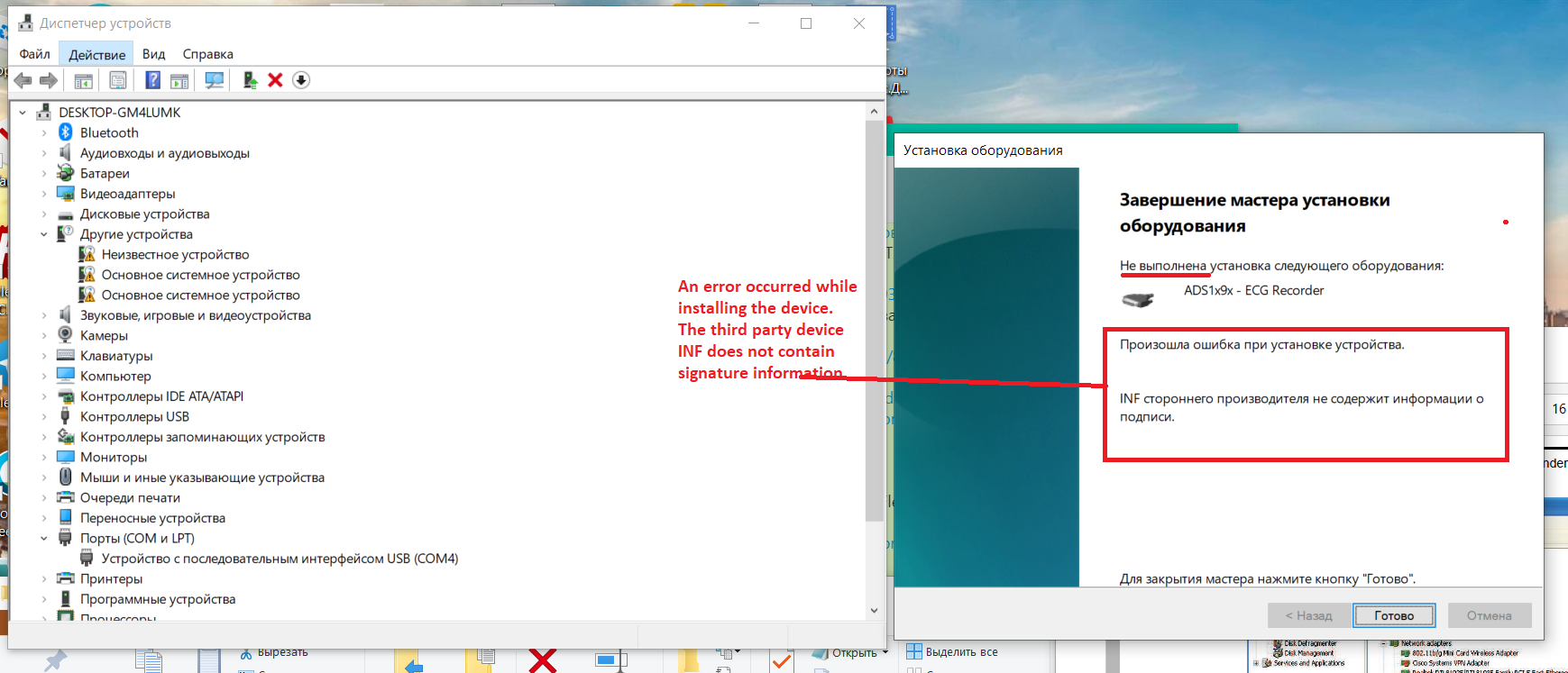

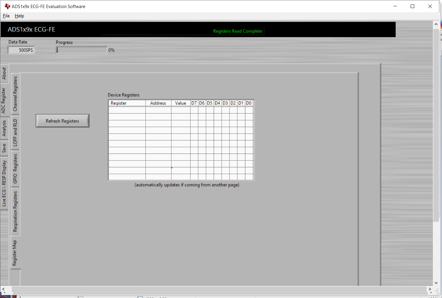

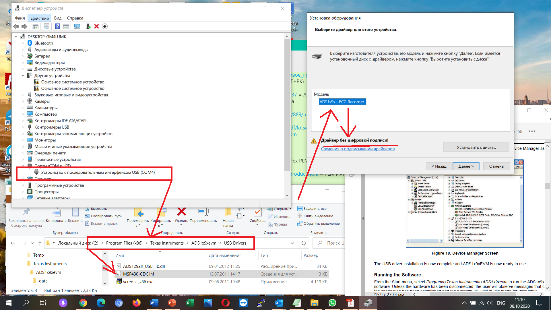

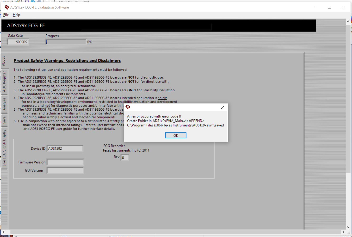

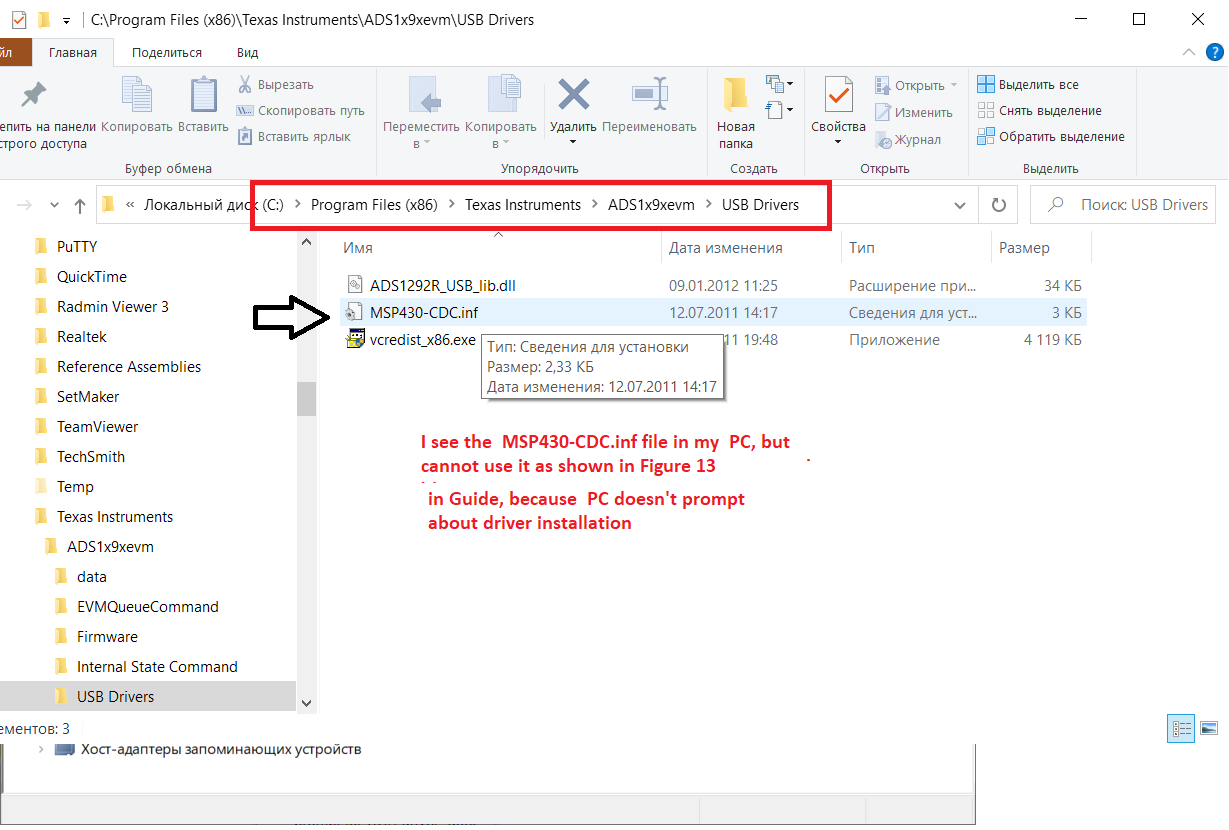

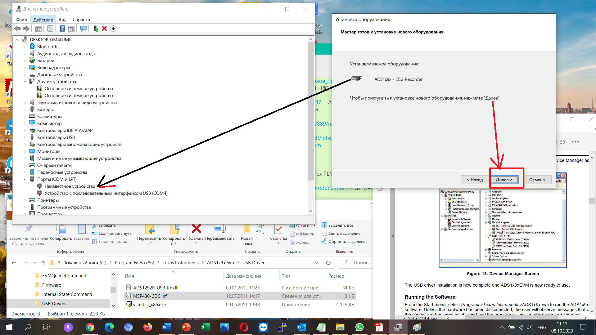

Windows 10/x64. I installed  SW  for ADS1292RECG-FE (CD REV-4) from  ADS1x92xEVM-SW-installer.exe (downloaded 01.10.2020)/ After successfull installation both NI and TI (and Vvisual C++) , rebooting PC and attaching hardware I start  ADS1x9xEVM. I set  Global Channel Registers, LOFF and RLD, GPIO as described in "ADS1x9xECG-FE Demonstration Kit Users Guide. Ch,4". But when I  try Register Map I see empty all values. Even I refresh Regiter map - All Values are empty/ How can I resolve this situation or what did I do wrong?
