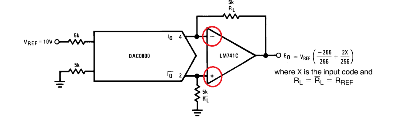

I am trying to debug a situation where I re-created a circuit fundamentally identical to the one listed in your document/datasheet SNAS538C ( DAC0800, DAC0802) page 10 figure 23 with the following modifications :
- the V+ is 12V - the V- is -12V
- the opAMP is an LM324 ( powered as well at +12V -12V )
- the Vref first been tried at 8.0V
- the resistors, to meet the 2mA requirement been changed from 5KOhm to 4KOhm
- Input are TTL level guaranteed to match the requirements ( i.e. Voh > 2.0 V and Vol < 0.8 V)
- VLC been set to 0V ( for TTL input )
In those conditions I can't make the DAC work at all, no matter the digital inputs there appear to be absolutely no variation in the output ( which seems to be stuck at 11.89 V about ).
Then I tried a "test rig" to try to nail down the problem ( see attached schematic , VCC  is set to 5V , so Vref is 5V ) but then again the DAC in those conditions seems simply not work at all.
I can't figure out why.
At this point some things are not very clear in the Datasheet, all the examples seems to show that Vref is always set at +0V, can it be set at any different value ?
Is that a VrefMin / VrefMax value that has to be respected and/or some relationships between Vref and Vsupply ?
The datasheet seems to mention the DAC0800 can work with a supply from -/+ 4.5 V up to a max of +/- 18V so I assume there should be no problems in working with +/- 12V ?
Thanks in advance for any help, it's really puzzling me.

    The very basic fact that you got your output railed out indicates some issues with LM324.
    Can you please verify the output current node rather than the op amp output, I believe you followed fig 23, in that case please measure the voltage across the resistor from non inverting terminal to ground.
    Also please share the schematics, Its very difficult for us to look at board and understand what is the actual circuit you built.

    just a quick reply, my schematics are in the attached PDF file, I can try to make a PNG print and re-upload it but they should be in the post.
    [edit] - here I converted it into a PNG, maybe that's easier to see.

    You are getting the expected output at IOUT.
    I am assuming you got negative value because you measured between GND and pin 2.  This is the configuration which I have asked you to test,.
    I strongly feel there is some issue with the op amp output.
    Please check the pads and connections one more time. DAC is working as intended.

    later on I'll do a few more tests, as it does happen while looking for things I stumbled across a similar schematics in a schoolbook using precisely the DAC0800 in a very similar configuration, even listing the expected V output for a given digital input.
    BUT .. in their schematics, the +/- pins of the op-am results "inverted" , I mean pin 4 of the dac goes to '-' input, pin 2 of the dac into the '+' input and there's a negative reaction so the output of the op-am is via a 4.7k resistor back to the '-' input of the op-amp.
    This is taken from a schoolbook text titled "Elettronica, le applicazioni" ( Electronics, the applications ) ISBN 88-7019-822-7 page 351 ( lab ) "Exercise 8.6.1" "Practical test of using a D/A converter with a uP" they even use 12V supply but with a 10Vref and they use an LF351 in place of my LM324.
    I begin to wonder if there's a "print error" in the datasheet about the op-amp inputs ?
    Anyway later on I am going to modify/test again .. I can't believe I am finding "the same thing done in 2 completely different ways" one of the two seems to be not working right.
    Cheers.
    Finally I fixed it, and now I am 90% convinced "there's a print error in the PDF/datasheet".
    After THIS MODIFICATION, compare it to the schematics above, ALL WORKS.

  • Hi Ivan,
    There is no typo in the datasheet. Mistake is in your schematics, if you look at your first schematics, op amp was connected in positive feedback eventually resulted in railing out. That's the reason I have asked you to remove the op amp and test ( I was just giving you a test to understand that :)
    You need to connect pin 4 of the DAC to op amp negative input and have feedback taken to output through the resistor. Pin 2 of the DAC should be connected to positive input and from the same node connect resistor to ground. That's the recommended implementation.
    Anyway you corrected the same and made it work. Also in your DAC symbol pin 4 is shown as I- why is that?
