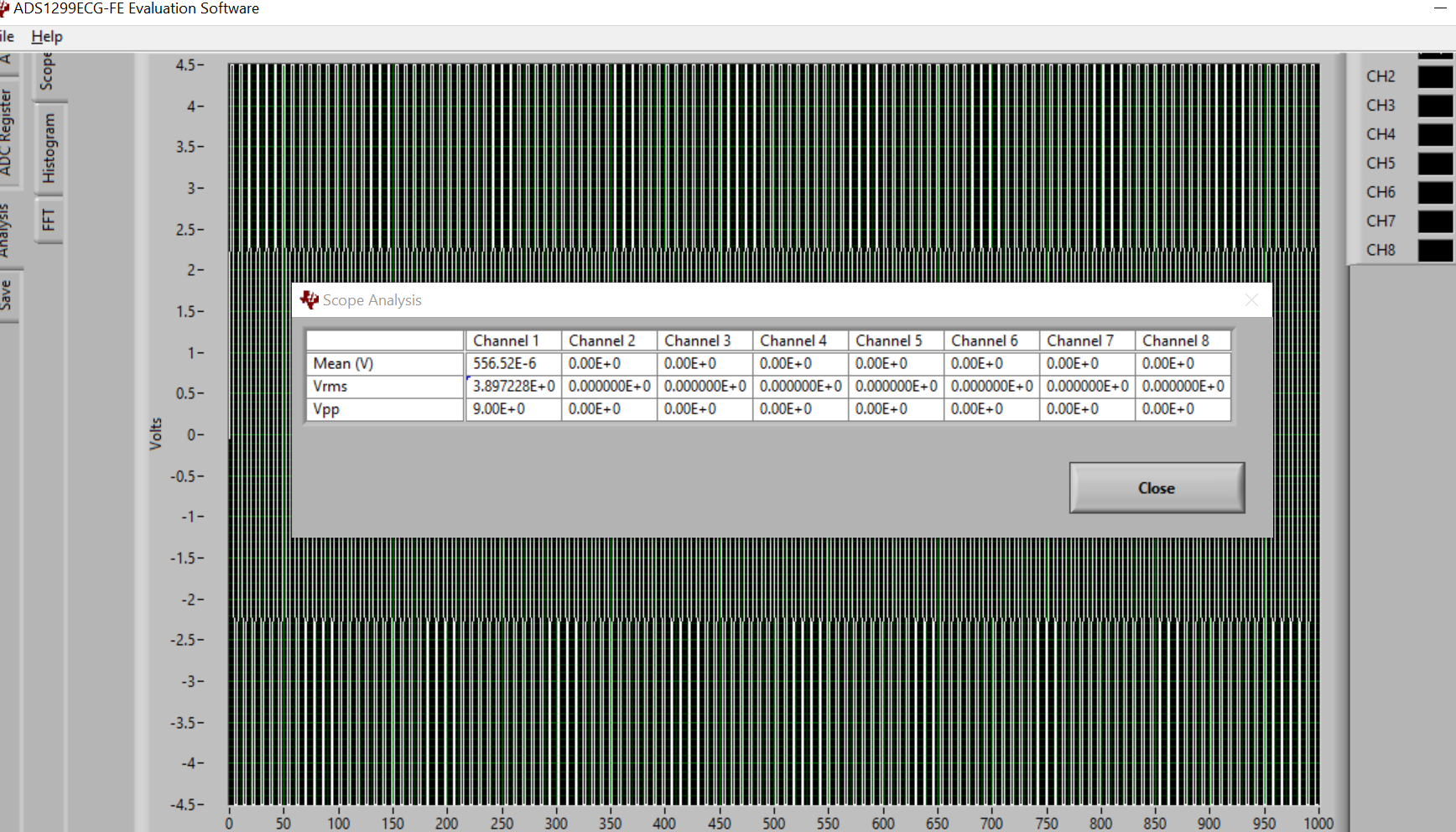

I testing function Lead Off Detection of ADS1299. I configure the Dev kit as below:
Lead off current 6uA
Ac lead-off detection at 31.25Hz
Gain = 1
LOFFP1, LOFFN1.
When I short P&N channel together, I can see 120mV peak to peak at the output of ADS
But when I disconnect P&N channel. I saw the output voltage swing between +4.5V and -4.5V. How can it happens? I think the output voltage should swing between VDD and VSS. My supply voltage is +2v5 to -2v5.
Looking forward for your answer.

  • Hi TCT,
    Thanks for your reply,
    I would like to send the picture of measurement again.
    This is the output voltage when I short P&N Channel together:
    And this is the output voltage when I disconnect P&N Channel:
    My configuration is
    As I knew that the input voltage can span from -VREF / Gain to + VREF / Gain. But how about the output voltage?
    In this case, when I disconnect the P and N channel, how is the current loop in the IC?
