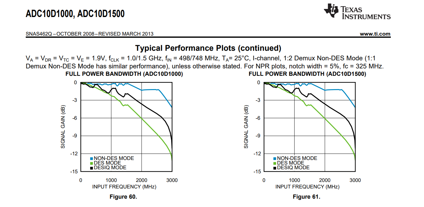

We are planning to use the part ADC10D1500 in our design at maximum possible frequency.
Please provide the analog input power loss vs frequency data. It is said that FPBW is 2.8G where the power would be 3dB less than fundamental. We need data over the range of frequency.
