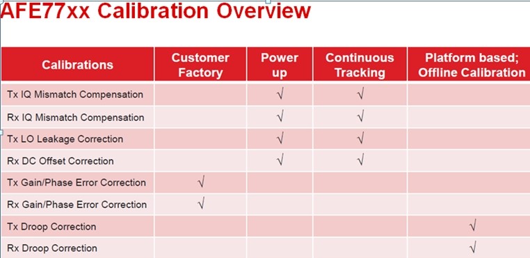

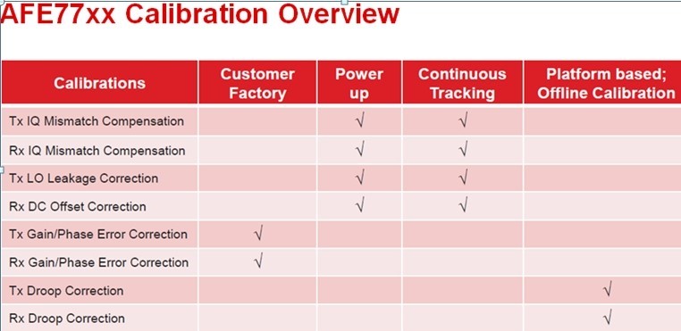

 We have two more questions for factory calibration of afe77xx
          1. Is the Tx&Rx DSA calibration refer to frequency vs gain and phase? not including temp vs gain and phase?
             If that is true, maybe we should do the temp compensation for the signal chain by ourself.
           2.You have provide us the rx Dsa calibration operation guide, is there any Tx Dsa calibration operation guide?

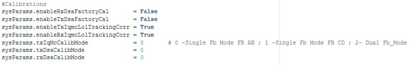

3.As refer to calibraton of afe77xx, we only find the setup of QMC & LOL tracking
              However where to setup the powerup calibration in the latte for afe77xx?

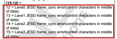

4. the link status of jesd204b is very unstable in our new version of PCBA
              After the afe77xx is bringup successfully,  the jesd rx will alarms frequently.
              The following the screenshot of erros after calling responding c function.
              we can see the register of 0x160 [bit15:12][jesd dac side] is 111,which indicate the frame_sync error
              What is the meaning of "control character in middle of data"?
              What may we do for debug the jesd204 problem?
