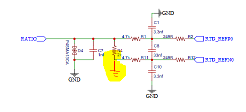

  • Thanx Bryan,
    I have attached schematic in the case attachment. Here I am unable to attache schematic file.
    We bias RTD by excitation current output 1 and output 2. please refer schematic.
    We use internal reference voltage. and . REFP1 and REFN1 reference inputs selected.

  • Hi Harshad,
    Thanks for the additional information and the schematic. It looks like your reference resistor (R4) is not grounded, so there is no path to ground for the IDAC. This would explain the values you are seeing, as the ADC does not have a valid reference voltage.
    Try grounding the bottom of R4 as shown below and see if it works.
    -Bryan
  • Thanks Bryan,
    I implement the solution suggested by you and it works and I got the ADC readings.
