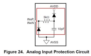

3. You are trying to configure PROTECTION CIRCUIT of ECG INPUT PIN, but the circuit configuration of DATASHEET and EVM is different.
Please check which circuit should be configured. (If you need to follow DATASHEET, please recommend the type of diode or product as well.))

    3. Figure 24 shows the device ESD protection and not the ECG patient protection. The requirement for patient protection varies from application to application. You will need to design the input protection circuitry for your application.

    3. I understand that the ECG signal input need to add a noise rejection filter. In Figure 24 (DATASHEET) and Figure 7 (SBAA188 EVK circuit), the RC filter has a different value, which value should I use?
    And can I use ARRESTER or TVS for the diode in Figure 24?

    As stated previously, Figure 24 shows the internal ESD protection circuitry for the device. These internal voltage protection diodes are there to protect the device from large input voltages or EOS events. External protection is still necessary for patient protection. Please refer to the link below for some helpful discussion on the protection circuit.
    e2e.ti.com/.../882080
